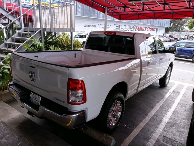

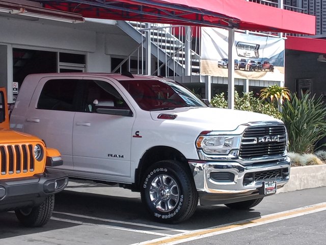

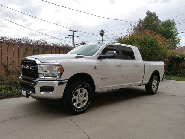

OK, so I forced myself to wait till April to check on my Truck. Then I called over there and the truck was there. 8 Weeks and one Day. Not even sure when it actually arrived. Don't care. While I was there I checked on the Super Stock. Yes the Drive Shaft was delivered as planned and my Car was on the rack, all the new Parts still in Boxes laying on the Ground. Busted Diff, Axles and Driveshaft on the ground. Yes it broke that ear off as is typical. An hour or two after getting home with the Truck the Super Stock was ready to go! What are the odds............ I will get it in the morning after they wash it. I have TOO MUCH playing around to do with this Truck to do right now.

A - nice truck
B - congrats on the SS being back in one piece
Good luck with them both. (y)

nice looking truck Ron! Should pull that SS no problem!
1,938
3,875
Nice RIG!!! Good to hear the Challenger is coming home soon too! Are you going to race it again soon, break it in, add a diff brace?
2,228
3,826
. View attachment 40620 View attachment 40621 View attachment 40622 View attachment 40623
Looks like you have lots of room to sleep in that thing!
