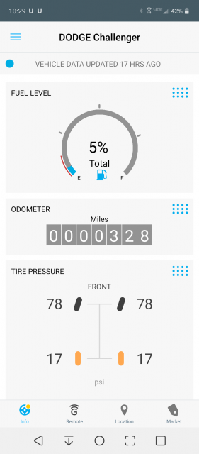

So, last Saturday when I was hot lapping making passes in the middle of the Red List Competition I received a Vehicle Report VIA Guardian. What are the odds of this happening? Do you think Dodge keeps a record of this???? Gulp !

Big Brother has black listed that cars warranty lol

That is great, Ron. No problem, looks like you may have been just low on gas going to evening services. Just a bit of air pressures out of balance on a new car is all.

78 PSI in fronts!!!

Paul, that is the Mickey Thompson Sportsman SR 28X6.00R18LT. They are F rated and good for 95 PSI. NOTE: This is the ONLY tire in that brand/style that has the F rating. I actually think the TPMS will read quite a bit higher maybe all the way up to 95 psi.
The car was running on my Street Setup and that is how I run them on the street. The car drives really well on that tire. Many times I forget I am on a Skinny.
The only problem when racing on them is they skid real easy. So when driving out of the burnout towards the starting line many times the front lock up when I get on the brakes. It's no big deal really but it is weird and I dislike it.

I run the same tire upfront now. I previously ran the M&H Front runner but changed after talking to a Mickey Thompson rep at Summit Racing in Georgia, having radials front and rear. FYI: I called MT technical support and they recommended 65 psi for our cars.

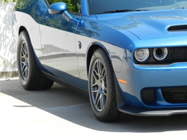

@Viper
The F14's on the rear of the Frostbite car were 17X10 +30 offset. With a 315/50R17 and yes you need max tub mods to make them fit.

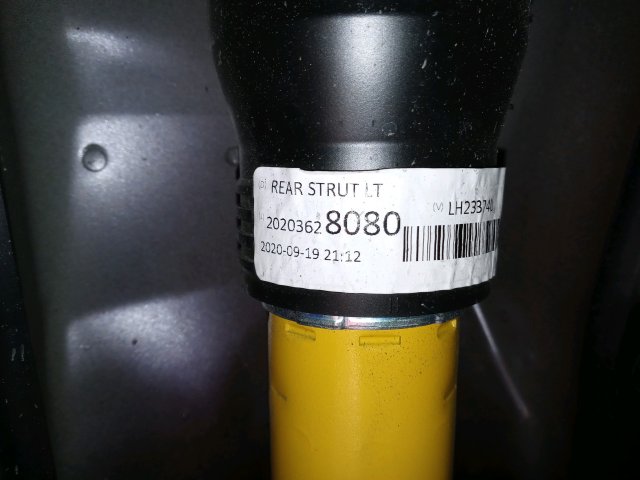

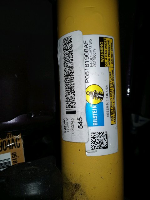

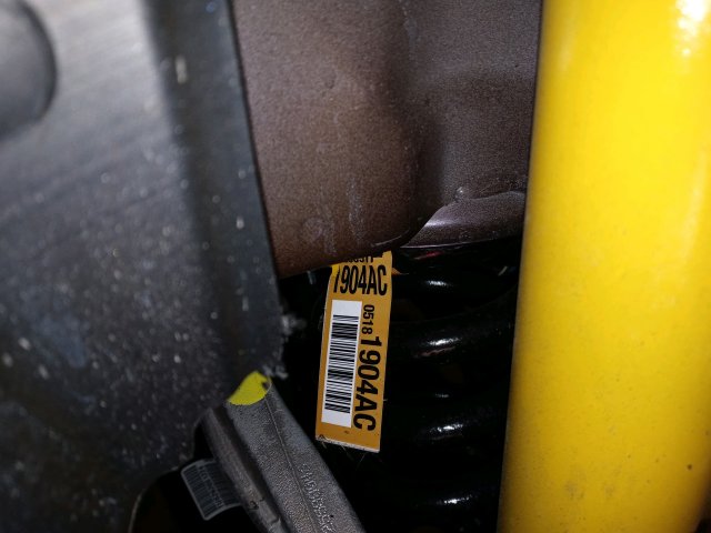

OK, so I was getting the car ready for Houston and changing out the Wheels & Tires and I remembered to take these pics for you guys.
I also verified that HPTuners added the support for the channels I want to Data Log. All of them work now.

I'm not up on the part numbers, is that a Demon shock/spring, Hellcat, or something specific to the SS?
