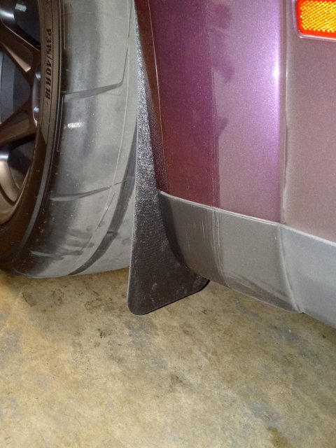

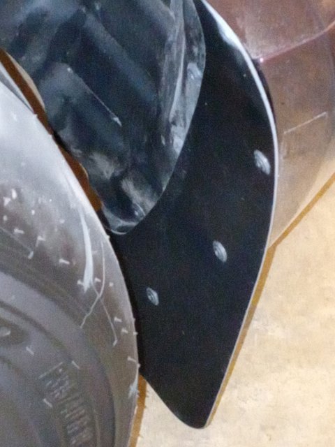

MUD FLAP INSTALL
I bough these Mud Flaps from https://www.vicrez.com/ and I was not happy with the Mud Flaps at all. Not entirely sure if maybe they sent me narrow body Mud Flaps or not. I have contacted them about the Mud Flaps not fitting right and they offered to help and I sent them Pics of the Mud Flaps but then never specifically said if the sent the wrong Mud Flaps or not. #1 they sent large round head self tapping galvanized screws to attach the Mud Flaps. They would have bore big holes in an area where there is not much meat. And the Mud Flap attaching screws would have stood out like a sore thumb. So I bought new Trim Screws at the Hardware store for the Mud Flap install. #2 the Mud Flap shape was completely wrong if they were in fact Wide Body Mud Flaps. The inside cut line on the Mud Flaps does not follow the edge of the fender so it was impossible to figure out where to drill the mounting holes into the Mud Flap. What I did to mount the Mud Flap was drill one hole at the Top where I could easily judge it. Then I pushed the Mud Flap against the Fender and made a Chalk Line (thanks Kids) on the outside of the Flap. Then I drilled my holes just inside the Chalk line on the Mud Flap. You can see this in the pic of the Mud Flap.
I was going to put Mud Flaps on the Front but decide not to because I did not want to distract anyone from seeing my little bitty inferior size front brakes.

My "splash guards" fit great. JLT

My "rock guards" fit perfect. Swaims

My Mopar splash guards fit good too :p

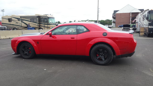

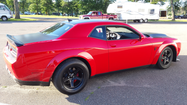

I run around proudly all season.
Wearing my dirty diaper. Screenshot_2020-11-25-12-19-00.png Screenshot_2020-11-25-12-18-24.png

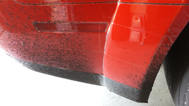

If you drive around with racing
Numbers.
