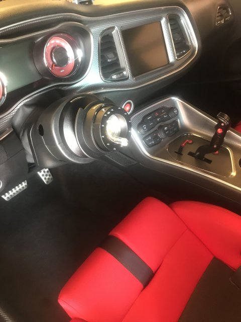

I am also working on how to adjust the Power Steering Column when the Driver’s Seat is removed.
@DodgeCares[/QUOTE]
Too late. I’ll just remove my steering wheel instead. 😝 362FD8EF-3B1C-42A7-A6DE-3120728B0FE1.jpeg 8E1E5150-EF58-47FD-8E4F-F6EE677B4037.jpeg

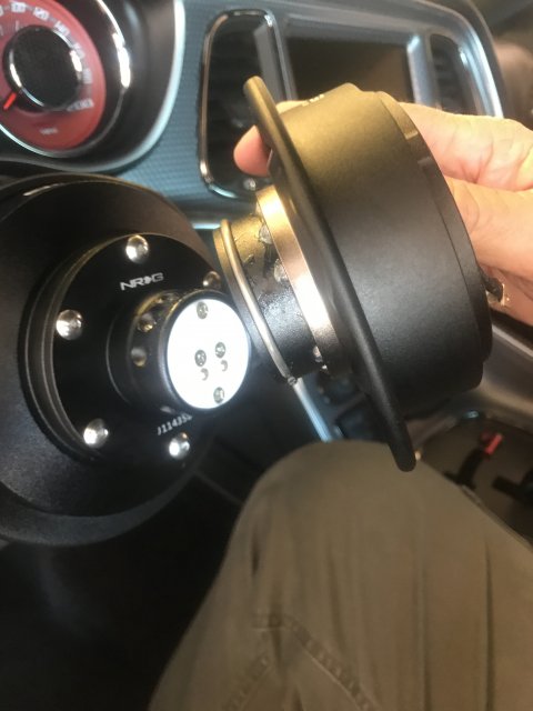

Too late. I’ll just remove my steering wheel instead. 😝 View attachment 18007 View attachment 18008
Nice! So you did end up finding a NRG quick release that worked(y)[/QUOTE]. Sorta. I took a chance on what they had listed for the 2010 thinking the spline/shaft configuration might work. It did. It’s unchanged. The hub itself though won’t fit over the new clock spring housing so I had to remove that. That means for the time being I won’t have the turn signals. They said that they will have the new one in the future. When they do, I’ll Spend the $100 for one of those and put the clock back. While all this seems extreme, in reality, I can put the whole thing back to stock for street driving inside of 5 minutes.
