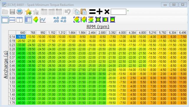

If you can get a data log on your car you can see what's up I think. The factory torque mgmt on a RE pulls the timing down to 4-6° at WOT during shifts but that wouldn't feel like it fell on it's face I don't think.
What I can say is I spent quite a bit of time dialing in the 2-3 shift on my car custom tuning it, but more so at part throttle. For example the car pulls -20° of timing at part throttle shifts! I obviously changed that. I never had an issue with any other gears just like you describe with yours. Just 2-3.
Here's the 2019 RE torque mgmt table.
