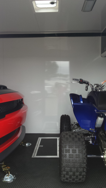

Dam. That's close
I'm glad I went with 5200lb
Axles.
I like my 18" 305s.
I have about 2" per side in the rear.
Sometimes I load it not perfect I just leave it.

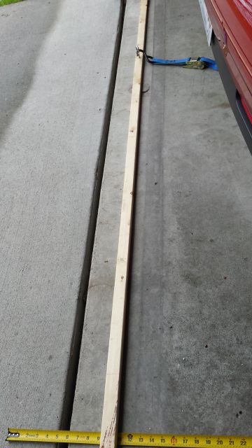

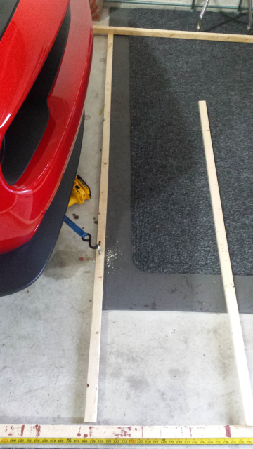

Before I built the trailer @ 24 ft.
I used some sticks to layout
The dimensions full scale.

I also made sure that the vent and batt. box
Were in reach while the trailer was loaded.
I know I would forget the vent everytime.
Before I load the car.
