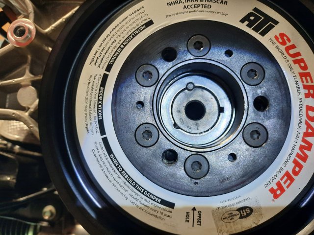

I still don't understand the logic of not having a keyway:unsure:

more fun 2nd time around, also this crank uses a key. double protected or overkill. I just know it will never be an issue.
Logically I can't see how it would spin

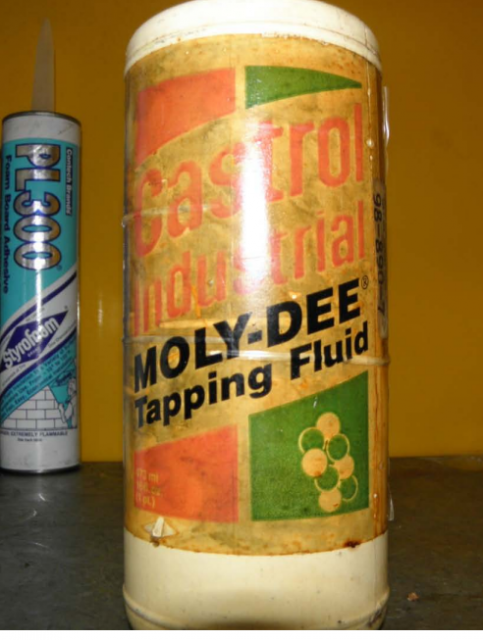

If you ever have to drill another dowel pin hole, I suggest using a screw machine length drill with a 135* tip angle. Preferably in Colbalt.
Don't laugh, but any hand lotion makes a get lube for the drill bit.
Carry on.

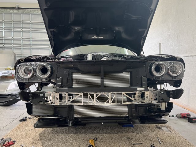

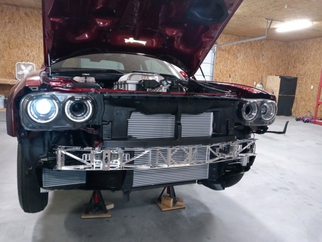

I am literally waiting for a new Splitter that I want to install before I put the bumper cover on. Just finished installing a new Mopar Low Tempature Cooler (for the Supercharger cooling) and the bumper support. And, I need rear tires. Then one short street pull and email that log and then head to Famoso to fine tune it.
what sort of weight savings with that impact brace / bumper over stock?
I am pretty sure it's a little over 15 pounds.
good luck getting new tires, most Hoosiers are on back order

I like that light weight front bumper, if it wasn’t such a pain to install I would buy one.
It’s really not a hard job at all, about 2 hours start to finish.
Yes, there is nothing super hard in doing it. I work a little slower than that tho.............There's a few little tricks that are helpful if you know.........But not bad.

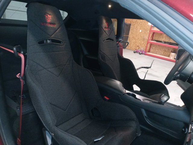

Seats are in..........
2 Kirkeys......

Two seats? You have to change your license plates now

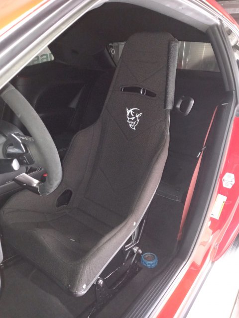

That's the Octane Red Car I am working on. No way would I put holes in my Carpet!
MY CAR :

Custom stitching?

Yes. I took the Kirkey Logo off and then had a Demon Logo embroydered on it to match the stock seat. I want the stock look in my interior. That is why I installed a stock seat belt guide as well as it makes it easier. My Friend Rob thought of that.
