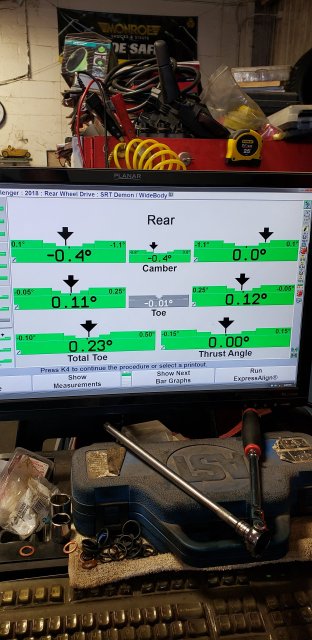

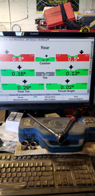

On a demon you want to set the rear camber to 0 the rear is locked solid and does not squat,on a charger or challenger hellcat .5 positive,all 4 upper arms need the same adjustment,set toe in rear a little toe in when it moves foward on launch it will be zero. The front wheels can be put to spec it has very good bump steer from the factory.

top pic is good hellcat,charger setup,bottom demon
Rt hand pic is demon have driver sit in car,demon spec on rt goes down to .2 positive with driver weight
