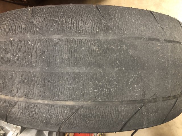

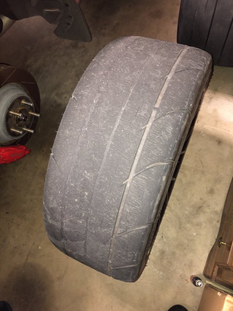

This some of the reason these tires looked like this after this days “practice” lol? Not worn evenly across?
95AFE868-BF24-4077-8E1D-7ACEF9D6CC0E.jpeg 4DE22747-3F32-45A8-904C-7A1AD9C512EC.jpeg DE1A7B9E-7870-416D-AF8F-38CB8A23ED4E.jpeg

I would imagine so. Possibly your toe setting a bit too. But mostly camber gain when it squats, exacerbated if the car is lowered. Why pay for the whole tire if you are only going use 3/4 of it?
The gentlemen who is going to set my car up and I had an in depth talk today. They are working on it this week. Does anyone know if taking the camber to one degree more than spec negative without any other adjustments will change the toe? Regardless we are going to see what happens if all four need -1 more, since I have the full set of AAD adjustable arms front and back.
If that is the inside of that tire, what does the other side look like? What did the track look like?
