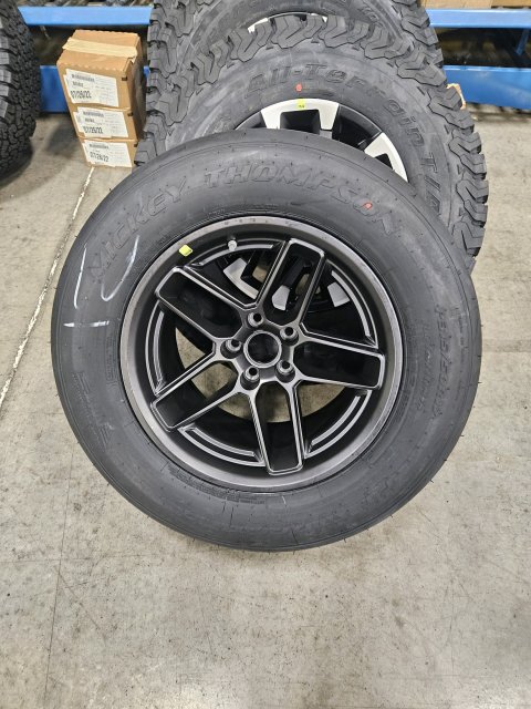

Tire’s not mounted properly 🙄

Wheel looks like a factory 20 in a 17 but doesn't look carbon fiber
Correct, but these are factory 17” rims and tires non CF these are the standard D170 rims
Exactly why they’re at the plant. Need to disassemble and remount a bunch of them

Makes sense. My thought was the non carbon were 20s but if the m/t are the only tire they would have to be 17s

Didnt catch that. They are directional so there shouldnt be an in or out?

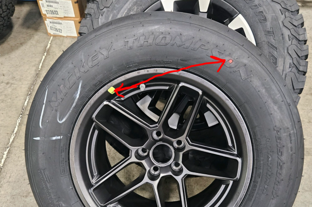

The red dot is on the tire for a reason. Lots of Utube videos on what’s up with that.

Something along the lines of wheel balancing
I believe the markings should line up

Not sure what the sticker on the wheel is for. On tires a yellow dot identifies the lightest spot and should be placed over the valve stem. The red dot identifies the shortest diameter of the tire and is supposed to supersede a yellow dot when balancing. Whatever’s going on it doesn’t look like they got it right 😂

Ya it sure looks like a lot of rebalancing going on

I know all that but tires shops never seem to do it

The first pass the wheel will spin :poop:

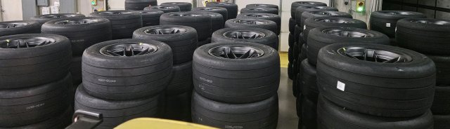

YIKES
(and still cool AF...). thanks for sharing BOBO!

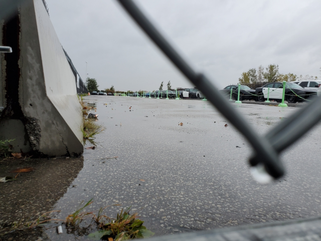

I went for a ride yesterday
Snuck a picture under the fence in the pouring rain
Yes the cars are getting wet
Hard to see but there are 6 170 s in this picture that I seen quickly
Many more mixed in with the several rows of vehicles
The fence took out the white 1 that was the closest
The green 1 in the back really pops
This is Windsor ON

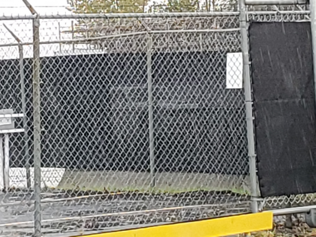

They hide this shit pretty good
White Demon thu blacked out fence
