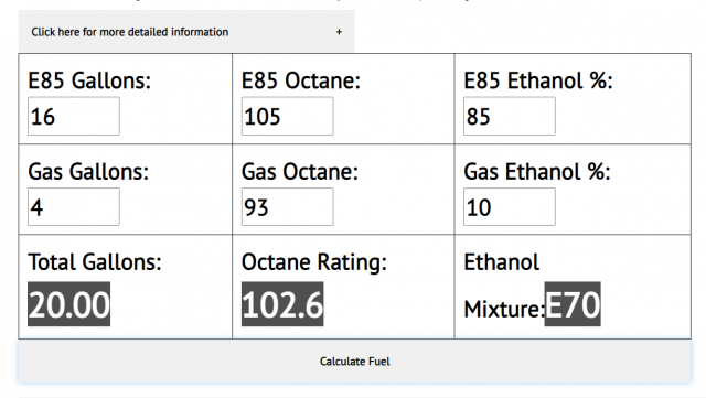

I don't agree with the sentiment that anything above e70 is good to go, I've had a shit ass time on anything but e85 or above.
vs rating of
this also assumes they cut it with 93, no one is forced to do do that...
vs rating of
Well, what you posted lines up with what I've been told. I'm not an expert here just sharing what's been told to me so YMMV but you can see the octane rating between E70 and E85 is very close at 15% less ethanol content and considering the volume of fluid as well there's the knock resistance. I've run my car WOT a lot on my E85 street tune on fuel that tested E70 and I never saw any STKR in the logs. I'm also not commanding 24° of timing either though. At the track I ONLY run Renegade Pro E85 so I know for sure it's good fuel with a good race base for that 15% that's not ethanol.

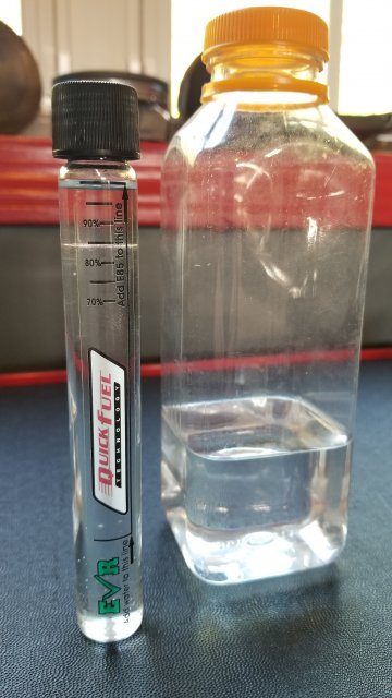

What e85 test equipment do u all recommend?
So do you come with a canister and buy a dollar worth before purchasing? Sorry 100% new to this so it seems logistically a bit 🥜! ;)
I use the Boostmonkey E tester. VERY simple to use. I keep a small gatorade bottle in the trunk to catch a bit of fuel at the pump and then test it at home. Not much to it once you get used to it.
This year that is what I have been doing, buying a $1 worth. I have a small container I put some in and test it when I get home. You can get testers on amazon
Thx. So the ounce or so in the” leftovers” from someone else’s gas up is enough to test? I’m just imagining buying 20 cents of gas to test every time 😂
