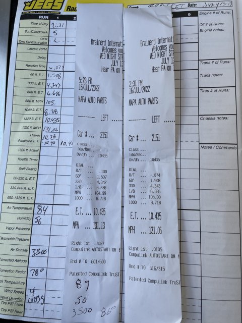

How are you guys getting your cars to hook up still battling mine run great times lousy 60’
17 psi mt street r.
Good burn out
Dead hook every time
I run half tank of fuel also.
60ft always the same as the last pass.
Et bracket racer.

Weight with half tank and driver no reduction.
4420lb
Every pass

With no weight reduction and DA at 3300 feet that’s about right.
