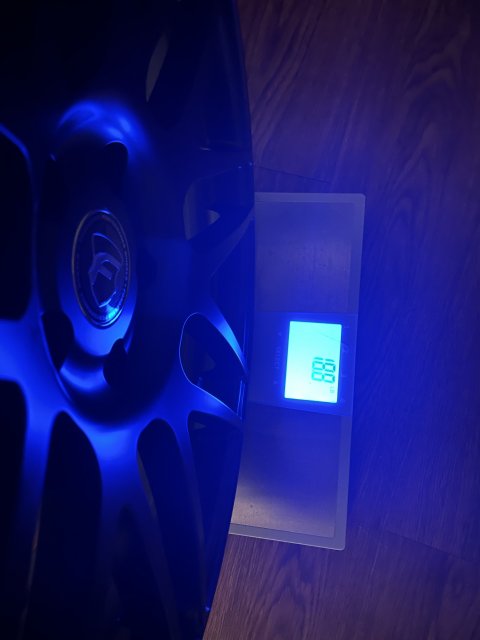

I've tried to find as much information as I can on the weights of these tires and wheels.
@vortecd something's not adding up somewhere maybe you can help. Your Forgestar F14 in 18x5 with a M&H 28x4.5 Racemaster tire weighs 34lbs? If the tire is 16lbs that would make your wheel 18lbs. However on Forgestars website they show a 18x9.5 weighing 17.6lbs so I'm surprised a larger wheel weighs less if that's correct. Also the Race Star 92 that I run claim to be 18lbs but with the same M&H 28x4.5 Racemaster tire mine weigh 38lbs. Where are the 4lbs coming from? Maybe my Race Star 92 wheels weigh 22lbs but that 25% more than all quoted weights I've seen. What front tire are you putting on the 17s? I don't know what a MT radial is.
I'm kicking myself for not weighing those wheels when I got them. Lesson learned.
Your racestars are 3-4 lbs more then the f14s each. My racestar m&h combo weighed 38 lbs on my scale also. Seemed on my scale the 18 f14 with the m&H was somewhere around 34.6-35 lbs then. I have a new scale and the f14 weight 34.1 lbs. On the same scale the 17x5 f14 weigh 16.7 lbs and the M/T ET street fronts 27x6 17 weigh 15.4 lbs
I put 2 10 lbs dumb bells on the scale and was 19.8 lbs so seems close

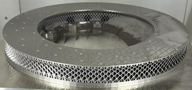

Speaking of light-weight things...
Fresh off of the printer...
