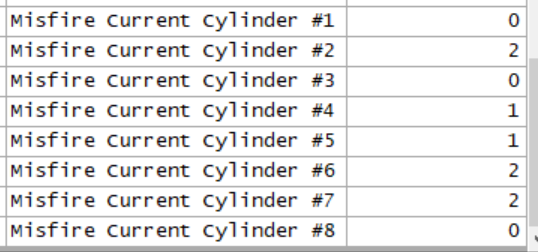

Lots of data logging this weekend. Probably my last check for misfires other than reviewing track logs.
My car just isn't exhibiting any misfire issues. This is another about 30 minute log from cold start with a wot pull at the end. Fuel was E66.
Two of these misfires in the log occurred before I even started the car. I keyed the car on, hit connect/record in HPTuners and before I could hit the start button two misfires were recorded. This shows some of these are for sure false.
1,602
3,990
Speedy - my experience diag'ing cars with misfires is....single digit type stuff like that is some kind of noise and not real. When a real misfire is present, the counter(s) will be much higher and often rolling pretty fast like a slot machine if real bad. I would say nothing to worry about in your case.
