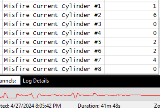

I ran a lengthy data log coming home from the cruise in the other night. This included a cold start, drive, and a couple of romps for good measure. I was curious what I'd see for misfires since there have been several reports.
Well....almost none over the nearly 42 minute drive. Mine was a later build. I'm almost wondering if some of the problems we've seen are from earlier build cars? RacerX's was 615 I believe.

@jonx96
I believe around 200 they shut down the cylinder. Unless something has changed on the newer
8,777
7,700
@jonx96
His dealer ticket must have only been stamped once with VIP and not twice
4,148
10,438

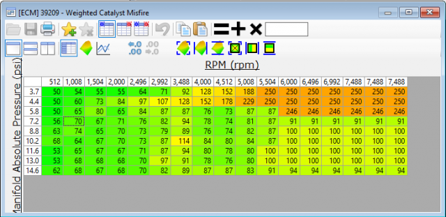

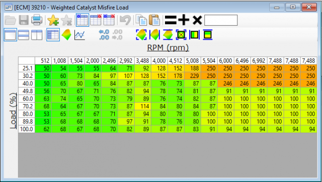

As the current cylinder #8 misfire record holder it is comforting to find out that these are not issues just related to my car. The Hellcat sees about 26PSI of boost in good weather. Misfires are turned off.
Map based table:
Load based table:

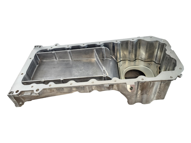

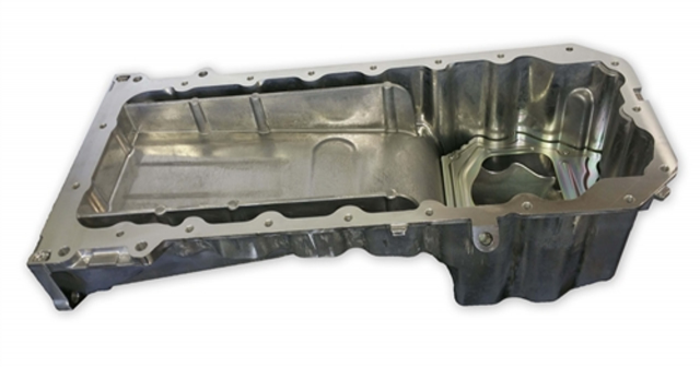

2015-2017 oil pan
2018+ oil pan
baffles were improved in 18+
8,777
7,700
Ugh, I need a new pan. Taking it off once and replacing the gasket while still in the car is enough for one lifetime for me though

Thread Starter #960
@fumanchu182 how are those misfire tables to be interpreted? Above those values sets a code or ? Is it cumulative or time based?
