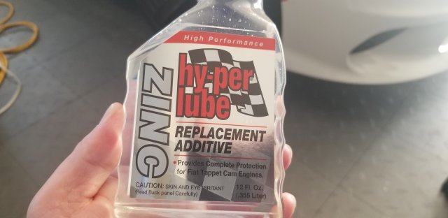

I know someone (scientist who works with these Polymers) who says this oil additive works...plays well with Zinc and doesn't foul up Cats. Who knows...thought about trying in Hellcat and comparing UOAs?
I've looked into that myself (the zinc). I personally prefer redline for various reasons, mainly just my personal experience with them (they are an ester / PAO based synthetic) but unless you're running in the top 1% of the performance range most any synthetic oil on the market (that meets minimum standards) will do the job. None is clearly better than another in any scientific testing I've seen (though stablity and consistency has been better in what I personally have seen from Redline, but that's only anecdotal).

I agree...the base oil is the carrier for the antiwear additives and any friction modifiers along with the detergent packages. From what I know there is no cleaning or lubricating advantage to a group III engine oil vs. a group IV (PAO) engine oil base. Though, PAO holds up better to abuse (heat), etc. thus providing extended oil change interval opportunities.
I am certainly no expert...just a hobbyist.
