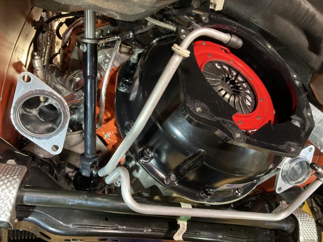

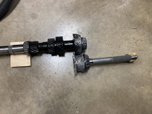

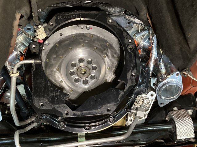

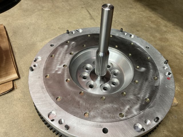

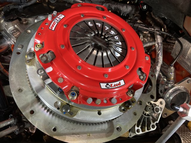

It could be the fly wheel friction surface the center disk friction surfaces or the friction surface on the pressure plate or all of them warped from overheating or have high spots on them from hot spots due to somebody slipping the clutch too much trying to make better launches or not knowing how to drive a stick correctly. I know you don’t want to take the transmission back out again and maybe I should’ve suggested such to you when you had the clutch out to take the pressure plate off of it and inspect the center member for flatness along with the fly wheel and the pressure plate it’s just that you have to have a steel splines alignment tool to get it all back together with correctly again or you’ll never get the transmission through it and into the pilot bearing. You could buy one that will work but you have to make a special tip for it to match the pilot bearing size,I could turn you on to what I did to make one or you could use a broken transmission input shaft which there’s many of them out there including I have one lol I could send it to you borrow if needed. I doubt it’s the master cylinder but $200 is a cheap try but not too easy of a change I don’t think, it resides under the dash not out on the firewall in the engine bay.
View attachment 67764 View attachment 67765 View attachment 67766 View attachment 67767 View attachment 67768 View attachment 67769 View attachment 67770 View attachment 67771 View attachment 67772

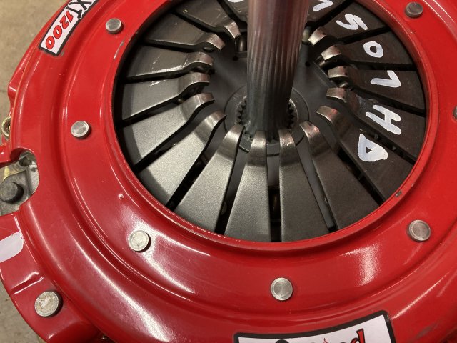

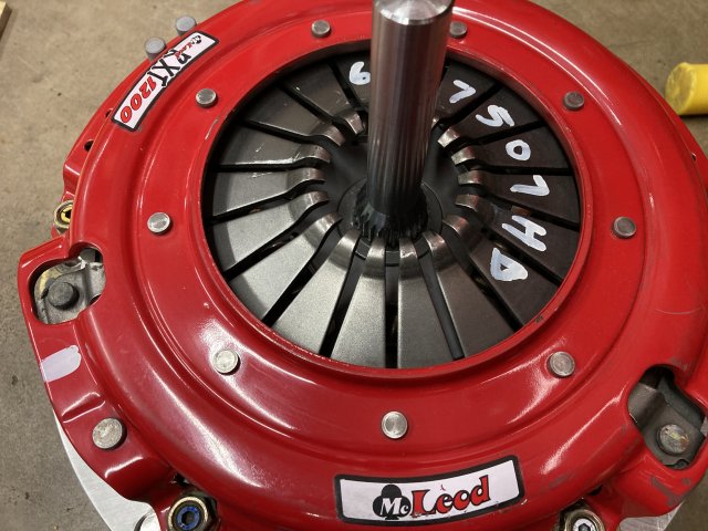

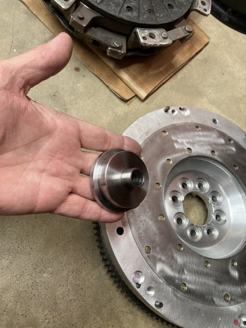

Doesn't Dodge sell the alignment tool?
I don’t mind pulling the trans again. Now that I’ve done it once, it should be a breeze the next time. Just takes a little bit of time but I’m in no hurry, can leave the car up in the air for as long as I want and just work on it when I want to and it fits my schedule.
It was worth it to pull it once and not spend the $1500 for a clutch just to see if cleaning the input shaft would work. If/when I pull it again, I think I might just replace the clutch with another OEM.
If it was in the clutch or flywheel surfaces, how would that explain the softer pedal feel (compared to the 2018 I drove?) Or are some years different! I thought the early years were supposed to be the stiffer ones.
Not that I've seen anywhere. But these are the correct tool:
- MMX - pricey.
- Summit Racing (ignore the photo--it doesn't match what they send)
- Jegs
I could never find one from Dodge the best is a input shaft from broken transmission give Rockland Stanard Gear George Mike they’ll probably sell you one cheap they have many of them laying around when this happens to the transmission which is often, The input shaft is useless and goes in the garbage except it makes a perfect clutch alignment tool of them a call if George isnt there ask for Mike he’s the guy in the shop that rebuilds these every day.

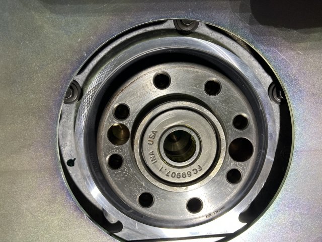

@BULL - if the pilot bearing/bushing isn’t perfectly aligned with the input shaft they make offset alignment dowels that move the tranny just enough to allow micro adjustments. You clock them as needed.The bolt holes usually have enough slack in them to not not cause problems. You can always hog out a hole a little, but the adjustments here are very small and that isn’t necessary.
