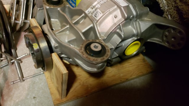

I was supposed to get you a picture of mine, will post in a minute after this.

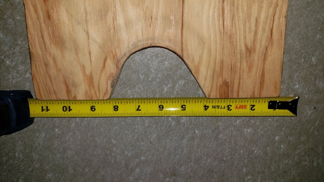

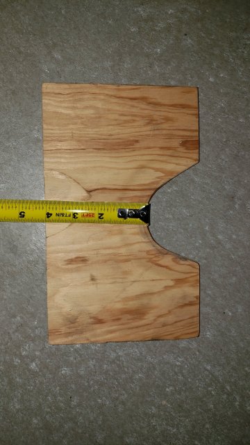

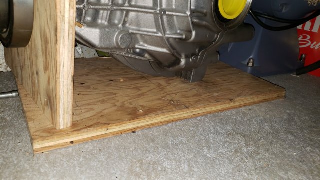

I made mine from 3/4" plywood. The front was a u-shaped/yoke thing that went up from a flat section of the plywood and "grabbed" the front input shaft/flange area. In the pictures, the front is unscrewed from the baseplate, but it was attached when I was actually using it.
I also drilled the lifting foot of my floor jack and attached the plywood base to the lifting foot so I couldn't slip/tip.
Pictures coming next.

Diameter of the cutout is 3", flaired out to about 45deg
If you happen to have 5/8" plywood, it will work better, the 3/4" is tight on the flange.
BULL, you are a good man sir!! Thank you for going through the trouble to post the pics.
many thanks !!
