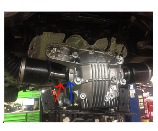

I put up a picture here Bull if you don’t mind draw two arrows to where you are saying to place the pry bars.
thank you sir.
the write up I linked suggests To only use on pry bar. It sounds like your method is a little more efficient/safer.
16,046
50,315
One one the front side, one on the rear, so one one either side of the axle.
NOW I GET IT !!!!! I am prying on ONE AXLE at a time, BUT using two pry bars at the same time on that axle to be able to pry out evenly!
