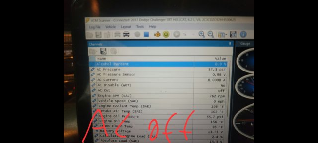

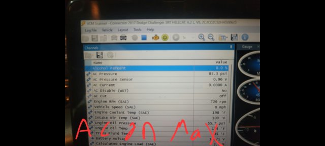

Kirk emailed me back. He thinks the AC isnt kicking on even though the clutch is enganging. The pressures im getting are very similar to static pressures without the ac on (even though it is) likely culprit is the high pressure switch. It had to be relocated when i did the interchiller. most likely somethings was bumped or loosened when removing the bumper to install new tank and cwa 400. No idea how to actually check the switch though so ill start with just looking at it and seeing.

You can log high side ac pressure in hp tuners and see if the data it’s reading matches your gauges.
Awesome. That should point me in the right direction. I bet I just snaggee a wire removing and reinstalling the front fascia. Im on the unit until 7p est. So ill get home and look at it tonight. Will update. Got a new tank to showcase for the community too.

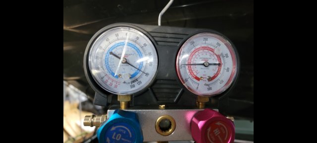

Static pressure if the compressor wasn’t turning would be the same on both ports. Gauge up both ports with everything room temp over night, should be the same. Once running and hot the static pressure may skew a bit because of temperature changes on section to another but 100 psi difference static does not sound right to me at least. My systems static pressure is about 65 psi at 75F, both ports. Goes up at temp goes up but stays pretty even on both sides until the compressor kicks in then about 50-60 on low side and 250-325 high side depending on air flow across the condenser

I think this pic shows what youre saying. Sane on both sides. The only issue is this is with the car on, ac on, clutch engaged and spinning. Spoke with another person and they agree it could definetly be the high pressure switch so ill comb over that when i get home.

I see what you mean now, hot that is a possible static pressure. Are you sure clutch is engaged? Is the center portion of the pulley spinning with the outer portion? If it is it’s sounding even more like the compressor took a slug of liquid Freon and broke.

AC on, everything spins.
AC off, the clutch stops spinning
Attached are two pictures of the Gauges. One with ac on and spinning. One with ac off and not spinning.

Bare in mind this is only with 2 cans of freon in it after vacuuming it down. I got 2 cans in and saw the low pressure side jump high so I stopped.

Pictures worth 1000 words. You can see where were at now.

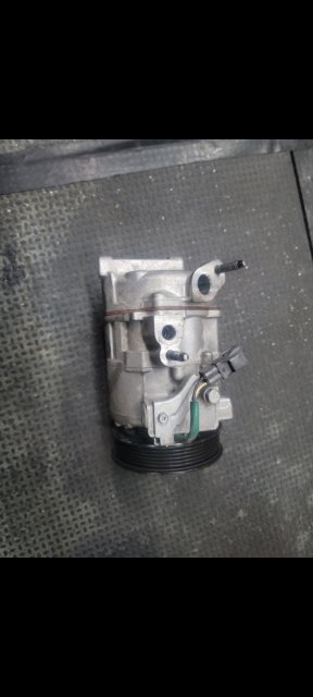

Fresh compressor in the AM. We shall see.
