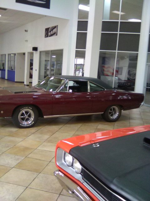

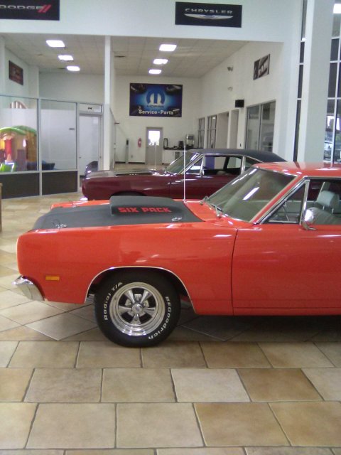

Dealer IMG_0230.jpg had these sitting on showroom floor
