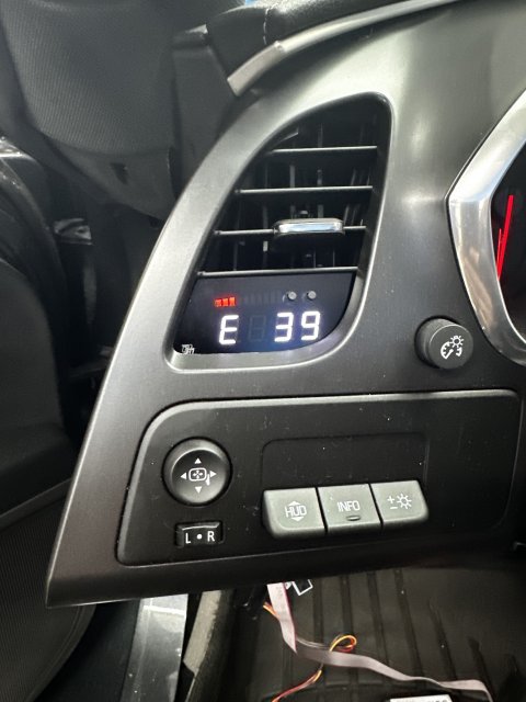

This is how you add flex fuel to my Z06. Add a wire from sensor to pin 39 on the ecm. Change one thing in the tune wam you have flex fuel.

Yes it does. I run my challenger on e all the time. My z06 also and next will be my c8. I have stations all would me with it.
