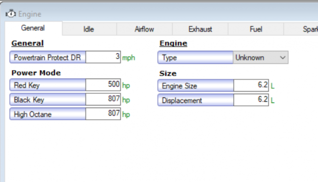

Got my bypass cable in today and read my stock tune...
What the heck is wrong with this picture??? Screenshot 2021-11-03 224526.png

#97
Keys are backwards on power rating.
You be slow with that red key.

Thread Starter #98
Screen says 807 HP with the red key... but why is it backwards in the tune?! The 2020 file I looked at was correct with red listed as 807 and black at 500. Weird...

#99
Maybe you'll get lucky and it's 870 hp and not 807.

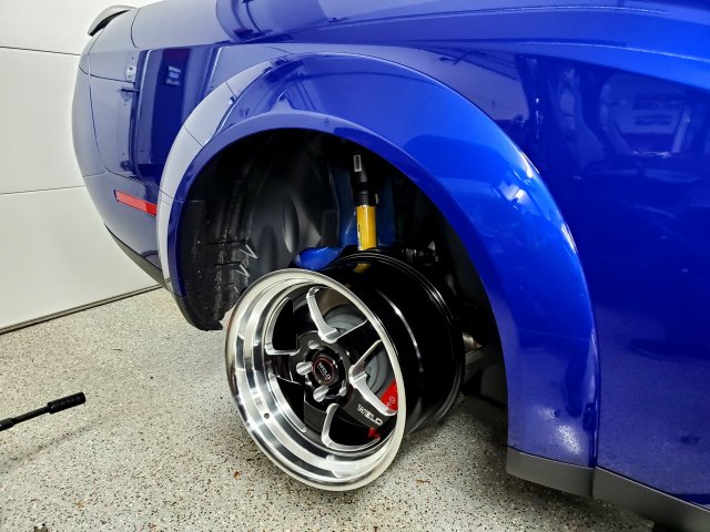

Test fitted my rear Welds tonight. There is only a finger width of space between the inside lip of the wheel and the sway bar, but guessing that should be ok. 20211111_182212~2[1035].jpg
