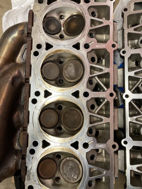

The pics he posted had like 1/4" of buildup on the exhaust valves that he had to use sanding wheels and a lot of labor to remove. I knew it turned stuff orange, but was very surprised to see that. I'll be giving the can I have away now.

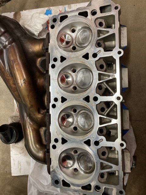

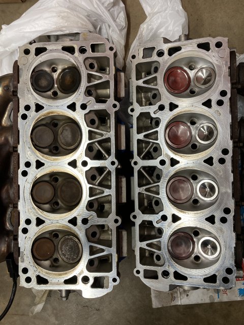

It doesn’t look that bad until you look at the exhaust valves and see from the cleaned ones they have a deep tulip to them that was totally full of MMT residue. Took about an hour per cylinder to polish them clean. No chemical of any sort could cut it, took mini abrasive discs to remove it. 994D399B-70B1-4126-B60C-5073A1C3555C.jpeg AB2543BC-4B9B-4619-B78C-8E8EBE0DDFEE.jpeg 694EC5E2-0126-49A2-A123-988FC740ECC5.jpeg

So you attribute that to Boostane? How much per tank? How long did you use it and was it professional or premium?

It was actually Octanium Unleaded, Boostane is even worse!! Anything that has MMT in it is going to produce the same result.

Agree, I used Octanium Unleaded for almost 2 years, about 8,000 miles worth. From monitoring plugs and O2 sensors in the exhaust stream I thought it wasn’t doing much harm, until I saw the exhaust valves when I pulled it apart to go forged. I can get 98 octane unleaded at Pocono Speedway which is about 45 minutes away only. I’ll be starting up and breaking in on that then going back to corn as soon as possible.

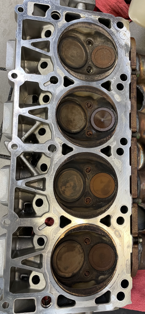

This one looks similar, but one seems not affected. 63191514-D1C8-4C15-8520-F6EBFE50BECA.png
