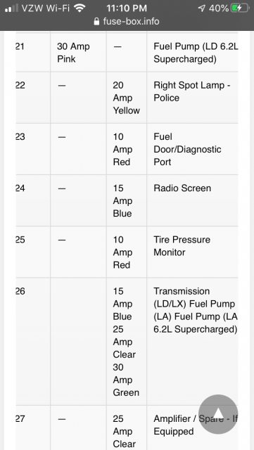

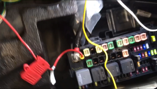

So check out this picture.
LX = older Challenger.
LD = Charger
LA = newer Challenger.
I imagine your instructions are either “universal” and therefore universally wrong, or they’re for a different car - the Charger.
I’m sure someone will have info for you in the morning, but if you’re trying to get it done tonight, I’d bet on 26.

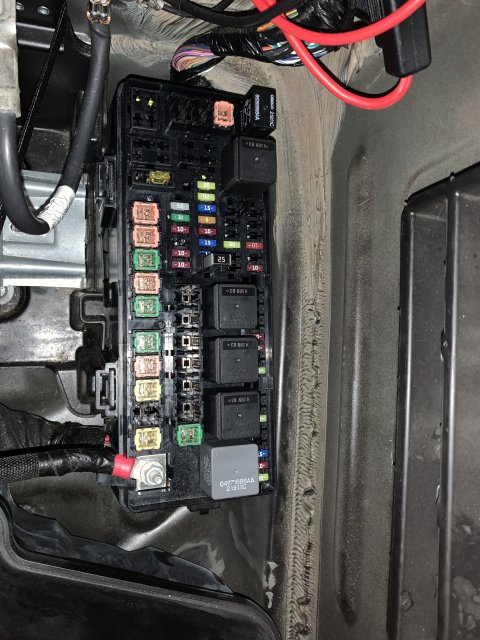

Attached another pic, this is the fuse block in my old 2016 Charger. Compare it to yours and see if thats the case (See if they’re different). Sorry it’s a crappy pic, I snagged it from my trailer hitch video, lol.

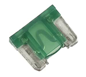

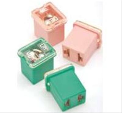

Thank you for the information, yeah fuse 26 is probably it but it's a low profile bussmann style like this:
They sent a maxi style fuse like this:
I'm gonna reach out to HHP and see what they recommend. I'm not blowing my fuel pump up, that's for sure!

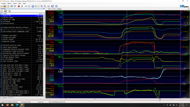

Not long, I'd say maybe four track outings and then that was it, my tuner was showing me where it would drop fuel pressure cause it couldn't keep up. It was the Kenne Belle BAP. IMO a bandaid. Get duals. Since you have a 2015 like me, it will definitely throw a code at the top end because you will be over volting the pump long enough that a CEL will pop and the pump will stop and drop and then you'll see it go south from there.
