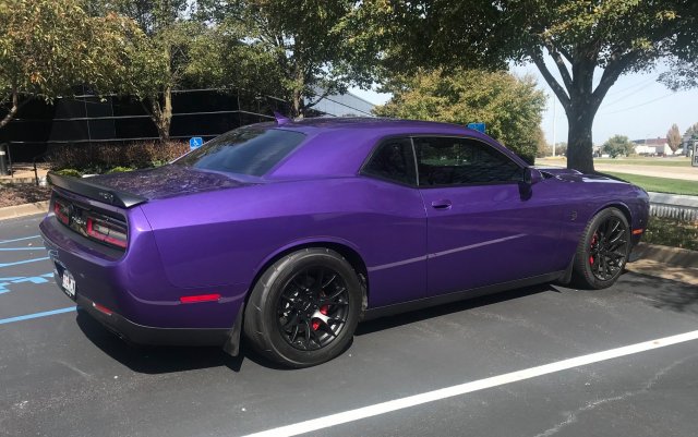

I'm planning to race my 2016 Challenger Hellcat in Hot Rod Drag Week this year. I've got a set of custom rear wheels that are 18" x 9.5" that match the stock fronts, and trying to determine the best tire for driving on as well as racing on. I've currently got a set of Nitto NT05R 305/45/18 tires and it does okay with them if I don't hammer it off the line. Car is making about 750 rwhp and first time at the track it ran 10.57 @ 135 with something like a 1.58 60 ft.in average race conditions. I think with a little more practice I can get it down into the 10.3s as it sits.
I know the 305/45/18 MT ET Street R would perform best on track, but since I'm driving and racing with same tire, I need something with tread that I can drive in the rain. The only other option I'm aware of with similar/better traction is the MT ET street SS 305/40/18 that is about 1.3 " smaller diameter (27.6" vs 28.9" for the NT05R). I'm thinking the smaller diameter MT SS might actually help a little on the track since I'm still using the stock rear gears, but don't know how the math actually works out. Here is a picture of the car with 18" NT05Rs mounted and links for both the tires.
Which tire do you think will work better for Drag Week ?

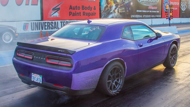

In the rain, the ET STREET R's literally must be driven at 45 MPH or less. I would go with the ET STREET SS 305/40R18 and you literally have to NOT stand on it when driving on the street. Sure you can drive normal and keep up with traffic but if you are WOT even in the higher gears those tires WILL wear out in no time. I would also keep the burnouts to a minimum on the track and be agressive on the pressure to compensate. I would shoot for 14-15 hot.
This is that ET STREET SS @14PSi hot and it drives fine down the track......
