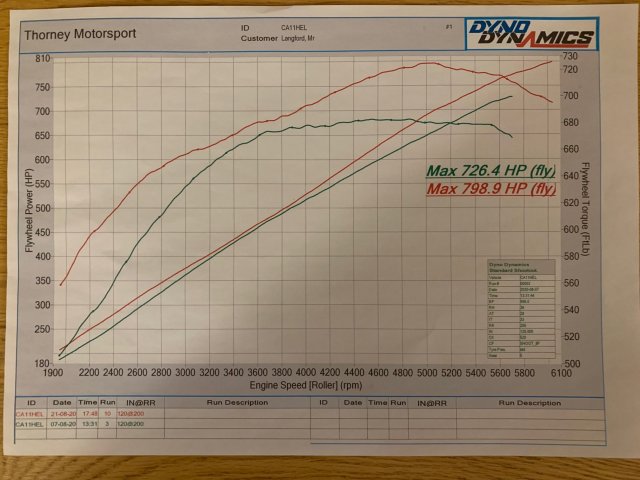

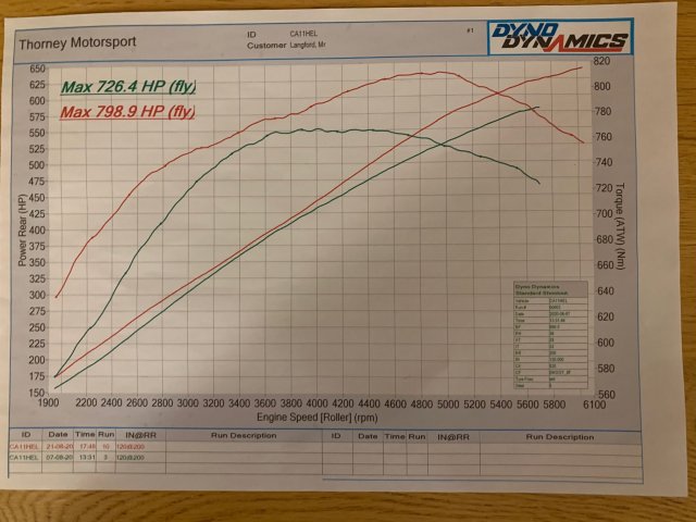

Well this is what we ended up with

Good gains,are you pleased with them and are you running today?

so 75hp for a pulley change doesn't sound too bad. How much boost did your car read before and after?
I emailed them last night at 10pm and got lucky. They had someone cancel 10 minutes after I emailed them. I'll post it up.
It is a long time ago since I looked at the boost gauge. I think 11lb from memory. Today I saw 15lb solid and then a solid 16lb in 6th gear.
