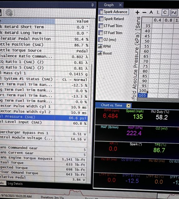

From your log running close to 30psi on the 3.8 is wild compared to my barley 20psi on a 3.0. What is the altitude and DA where you are? I am trying to figure out how you're not maxing them out and I am.
3,777
8,931
Thread Starter #30

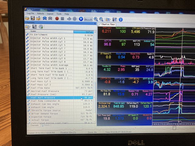

Did a 60-130 pull last night, traction SUCKED, had to leave my underwear by the side of the road after the run lol
Yes, a bit of a down hill slope but only 8-10 degrees of max timing commanded and traction control took it away as fast as it dialed back in
DA and temp on top. Not my best run but based on cold road traction it’s all I was getting lol
RGPIII
7 Second Best E/T
#983
1,120
2,098
Bridgeville
DE
