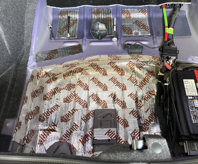

Sound dampening update...today spent several hours installing Kilmat product. My friend did most of the work and I tried not to get in his way. We applied sheets and cut to fit pieces inside the entire trunk cavity.
There is Kilmat under the trunk lock, and we put some around that silver screw to the left where the sub-woofer tray has a hold down nut. I also appropriated my wife's yoga mat and cut it up to put its rubbery thin material under the fix a flat holder, inside the fit a flat holder to secure the thing, and under the tray itself. And we pulled the trunk lid liner and put some Kilmat under the trunk lid. Only a little bit of this Kilmat is visible with the trunk liner removed looking at the sub tray and battery. I'll take a picture tomorrow.
A lot of effort and...only marginal improvement. At the same 31 volume level there still intermittent rattling to the same Led Zeppelin song. It might be one of the subs is defective. It is definitely coming from the rear and underside of the car. With the car up on a lift the last thing we did was put some Kilmat on the underside of the trunk up on the sides where it can't be seen, and where it probably won't degrade much.
Long day...will sound check tomorrow and update progress again soon. At my normal listening levels I think we may have addressed the rattle/delay effect coming from the underside of the trunk - I may not hear the delay because the rattling won't be happening. I hope to hear improvement when road tested. Hopefully those last few Kilmat applications on the exterior of the underside of the trunk space under the car will help ever more.
So this thread still open and I'm interested in more comments.
