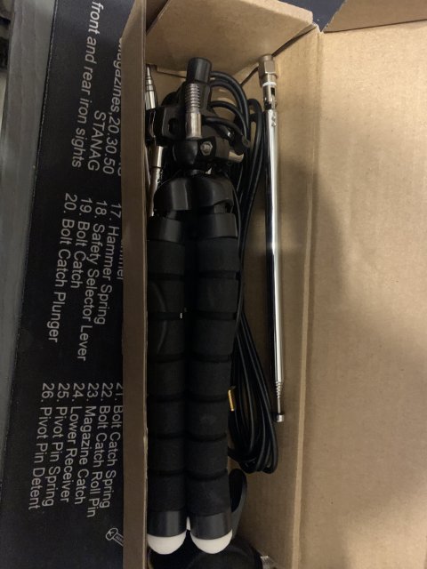

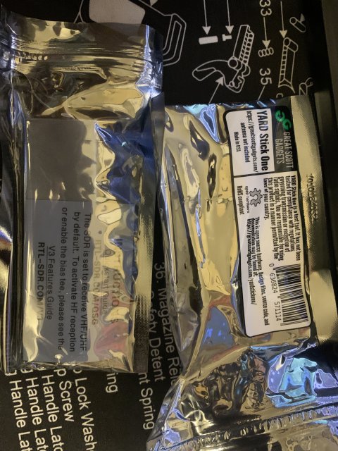

Got some toys in. Gonna see if I can do some work on it this evening.

To start off I researched the devices. All key fobs are under a FCC id so I decided to hit up the FCC database and found the filings here: https://apps.fcc.gov/oetcf/eas/reports/ViewExhibitReport.cfm?mode=Sum&calledFromFrame=Y&RequestTimeout=500&application_id=spKnbExGiCHJozOZmVpVNg==&fcc_id=M3N-40821302. The is all public knowledge and open source research. The most important records are the one with the RF Frequency information on them: https://apps.fcc.gov/eas/GetApplicationAttachment.html?id=1386312
So the plan is for me to sit in my garage with my fob upstairs and try and do the following.
1.) Attempt to open the door -> send LF message out but key fob is upstairs so no one is listenting, or are they?
2.) Intercept LF message with laptop nearby -> replay message with amplification so whole house is covered, therefore the FOB should reply.
3.) Fob responds with message but car doesn't have sensitive enough antenna -> intercept message at laptop with sensitive antenna and spoof RSSI information to gain entry and start car.
I will not be going into any technical details on how to do this. 1.) Illegal 2.) I would notify FCA first of any findings as required by law. 3.) Don't want anyone elses car to be stolen.

I've set my car alarm off twice, disabled my key fobs by recording the signal and then replaying thus taking them out of sync. When it's not 8pm at night and I'm not trying to set the alarm off in my house I'll play with this some more.
