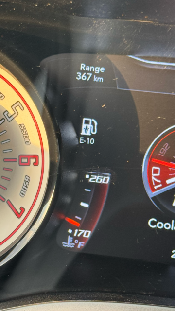

Thread Starter #26
Car is running and driving, flex fuel works, shows E content in the cluster, EPS works, now we have to work through a bunch of gremlins. I bought a used Adaptive Damping Module from a 2023 Hellcat that isn't playing nice, hopeful to find an EFD file for a D170 and try flashing that to the damping module, but will most likely have to buy a brand new one specifically for a D170. Also going to have to swap out my ABS module as that isn't happy either. I haven't added any of the AC stuff yet but that will be done shortly, pretty much all of the lines are different than 2015 hellcat, the AC compressor is also unique to the cars that came with the factory chiller, and I'll also have to add the factory chiller in. The intercooler pump won't run for some reason, it gets commanded when the car first starts and then spins down after a bit and shits off, I can seem to command it on with a Tazer though and it will continue to run.
