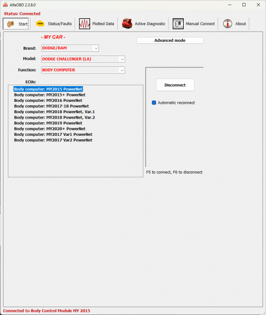

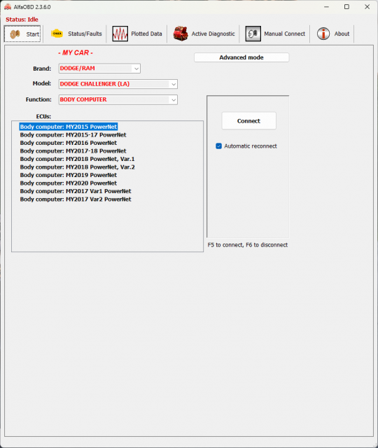

I had a really bad experience today with Alfa OBD and my 2015 Hellcat. Scenario... Talking with @jonx96 on the phone and he mentions he's mucking with Alfa... Okay let me give it a shot.
I connected my MX+ via Bluetooth, disconnected my Tazer but left the MPVi2 on the splitter. Started Alfa selected the following:
Hit the connect button... Car went absolutely fucking nuts. Windshield wipers went off, it was in some sort of funky diagnostic mode but something wasn't right. Couldn't turn the car off. Closed Alfa and disconnected the bluetooth module, pulled the battery terminal because it's as if it went into programming mode but got stuck. Freaked the fuck out and called @jonx96 while the battery was disconnected he held my hand and helped me breathe lol.
Reconnected battery, plugged in MPVi2, wrote the entire OS, engine and trans calibration. Go to attach my Tazer and it's not married? Great, did my BCM just get fried?

No, you’re fine. But I don’t like the windows version. Android version is more fool proof. Make sure the drivers are updated on your MX+. I would never have HPTuners hooked up while doing this, this should be the only dongle connected to the car.

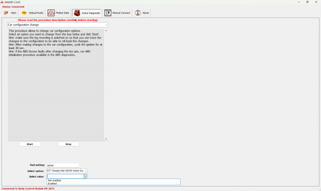

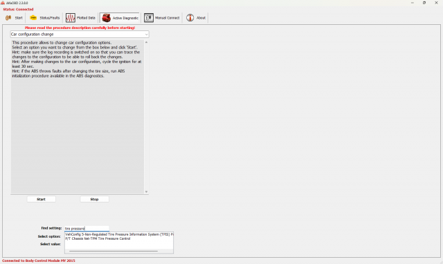

How do you disable suspension and tps ?

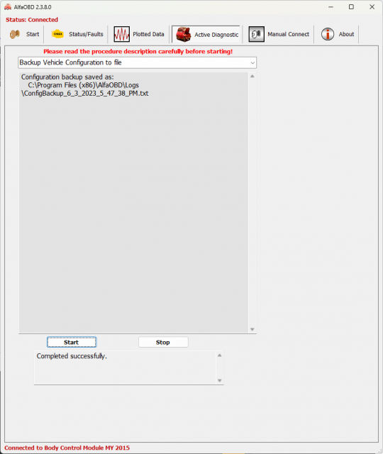

First, DO NOT HAVE ANYTHING OTHER THAN THE BLUETOOTH MX+ OR SIMILAR DONGLE ATTACHED.
Second, make a backup, connect...
Head to Active Diagnostics and then selected Backup Vehicle Configuration to file
30 seconds later:
Now... YOU ARE READY TO FUCK SHIT UP ...
Have not tried these myself but maybe these are the settings you are looking for...
I think it's a typo in the software"Active Dumping" vs Active Dampening Control Module... give that a shot.
For TPMS
let me know if these work for you...

I think I got it still says service TPMS system
