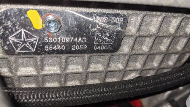

Today I heard the dreaded sound of a supercharger bearing failure on my '19 Redeye with 2,000 miles on it. I'm beyond disgusted with the ownership experience of this car. I've dealt with a misfire on cylinder 5, alignment issue, rusted rear brake rotors, hood scoop bezel popping out, rear end that whines and now a supercharger bearing has failed
Please direct message me if you have successfully completed a buyback with FCA.
For proof, reference and tagging I attached a video of the noise and a picture of the part number 53010974AD

Maybe it’s normal, but that part number plate looks like its lived a longer life than 2k miles.

When was the car produced?
12,322
65,674
I thought of that but it looks Ike it could have come from the engine compartment of my Michigan winter beater with 125k on it.

@Hellcatcfp Not sure what my plans are yet. Ideally, I want a Redeye without any major issues...but I ask myself is the headache worth it? There are a lot of other things to do with >$70k dollars
@DGatzby I had a ’16 Hellcat and the supercharger went bad at 1,800 miles on that one. So I’ve been though this drill before and realize it comes as an assembly that they swap out. Pretty straight forward job.
@Paladin06 The build date is 11/19
@BULL That's the part number on the back of the supercharger housing.Pain to reach... Is there another location to look for the part number?
No, that's it, but I'm just confused by that p/n. Doesn't mean anything, but it doesn't come up, nor match the replacement p/n.
Mine was produced the same month.
