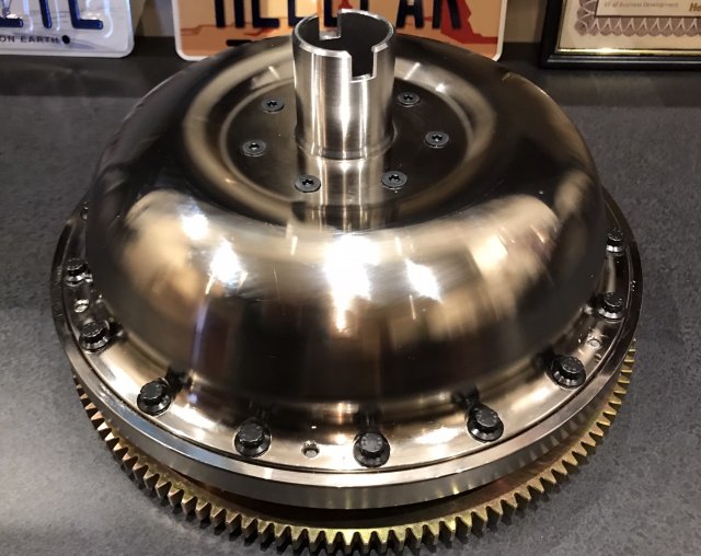

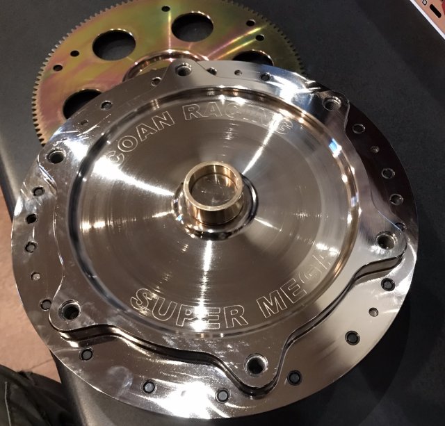

@zht. I’ve enjoyed some enlightening conversations with some experienced racers about converters and the science that goes into making those things work. One of the engineers (Todd) at Coan Engineering has been a huge source of information and set me up with what they call their Factory Showdown 400. Proper 1st and 2nd gear ratios for my car and a custom designed converter for the 400 using a long list of specs to work with the new motor that is being built to use the 3.8 Whipple. These things don’t work like what everybody is used to with the hp90. CBA2C3A3-4419-4A7A-9DD6-C5602BD603F2.jpeg B09C9740-DBFC-4088-B621-111C7E605166.jpeg

That's pretty. I've owned a few different brands of bolt together converters. It's soon handy to be able to change converter characteristics right at the track.
The Coans are good people. Jason is a customer of ours. He's a good guy.

6,139

Lol. No. I would speculate that Z might stay with Paramount. If he might consider changing, I would highly recommend Coan. One of the best customer service experiences I’ve seen. The blue car has a Paramount with a Neal Chance converter.

@zht. I’ve enjoyed some enlightening conversations with some experienced racers about converters and the science that goes into making those things work. One of the engineers (Todd) at Coan Engineering has been a huge source of information and set me up with what they call their Factory Showdown 400. Proper 1st and 2nd gear ratios for my car and a custom designed converter for the 400 using a long list of specs to work with the new motor that is being built to use the 3.8 Whipple. These things don’t work like what everybody is used to with the hp90. View attachment 99238 View attachment 99239
Work of art 🎨
