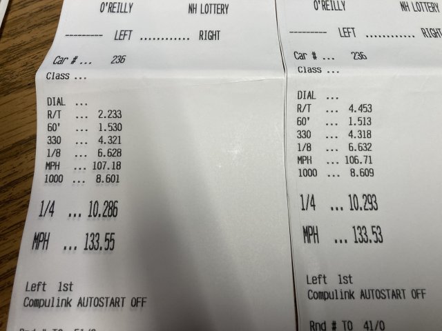

4,272
10,406
20HCM6 22RENBS2
1.5's in the 60 with LC.

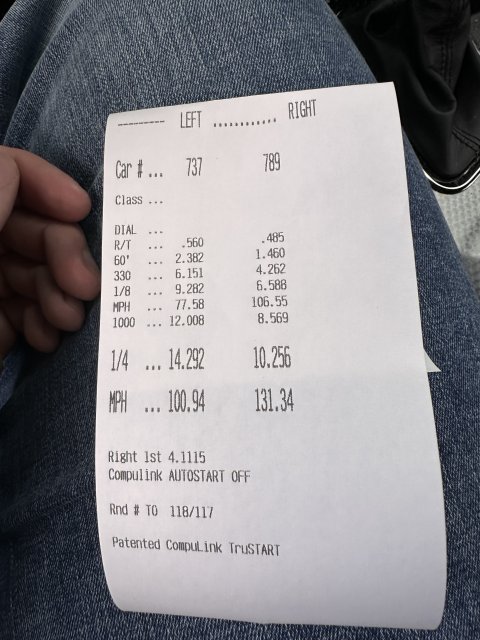

7,309
19,162
I was achieving consistent 1.4x 60 foots in Go Man Go but it took me years to get it dialed in.
