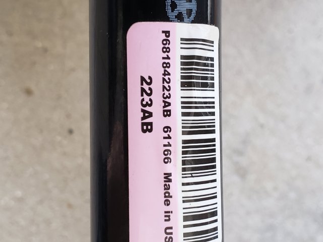

Well our heavy ass Chargers are not getting the weight from the sway bar. Hellcat Charger sway bar weighs 10 lbs. This is bar only no end links. Good news is I don't have to buy a light weight sway bar, I have one 68184223ab. Can't believe the Challengers are getting an 18 lb sway bar. Maybe mine is hollow and those are solid? hellcat charger bar.jpg .

Well our heavy ass Chargers are not getting the weight from the sway bar. Hellcat Charger sway bar weighs 10 lbs. This is bar only no end links. Good news is I don't have to buy a light weight sway bar, I have one 68184223ab. Can't believe the Challengers are getting an 18 lb sway bar. Maybe mine is hollow and those are solid? View attachment 20658 .
My 2018 hellcat challenger had a 20lbs solid front swaybar . The rear is solid too but I forget the weight .

2016 Challenger Hellcat front bar 68235661AC weighs 20 lbs bar only. Sure the 2018 bar is same part number
So if you have a Challenger Hellcat you can save some weight
