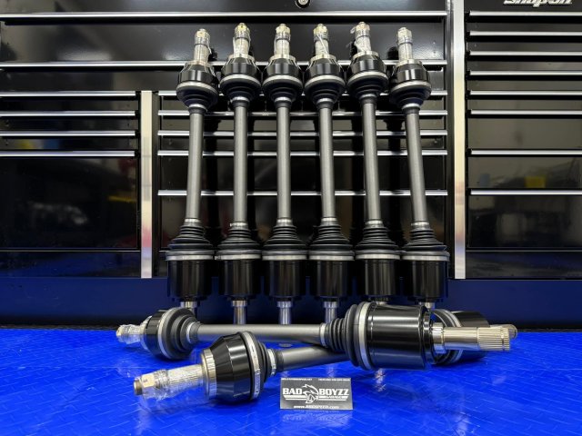

#12838
347
1,221
Martin
2018 Dodge Challenger Hellcat
https://mooredperformance.com/produ...hallenger-charger?_pos=1&_sid=f4d2f0938&_ss=r
Bad boyzz
BBGSPEED HellCat Billet Series 4340 / 300M CV Competition Axles
Race Proven!
Due to high demand from our customers and Dealer Network we are currently machining a new 60 set production run after our 1st 50 set machine run sold out! We appreciate everyone’s support and now offer a lifetime warranty on your purchase
Don’t miss this production run and secure your set today!
Retail $3,295.00
Racer $2,999.00
Shipping August
(1) Specifications
:Outboard Billet CV
:Solid 1-Piece Design
:4340 Billet
:Cage 300m
:Race 300m
:Severe Duty
:Axles 300M Billet
:35 Dana Spline
:1.5” Diameter
:precision Gundrilled
:Severe Duty
:Inboard Billet CV
:4340 Billet
:Cage 300m
:Race 300m
:Severe Duty
(2) XP Heat Treatment Technology
:Billet Copper Core
:Increased Rockwell
:Hardened Bearing Race
:promotes Severe Duty-use
:promotes Longevity
(3) High Temp Synthetic CV Racing Grease
:Shock Protection
:Cooler Running
(4) Powder Coated
:High Performance Spec
:High Heat Resistant
(5) Lifetime Warranty
(6) Fitment
:HellCat
:Redeye
:Demon
:Scat Pack
#12838
347
1,221
Martin
It was decided to move away from the polished nickle as the new designs heat treatment process is a crazy process and strength was decided on over looks.
