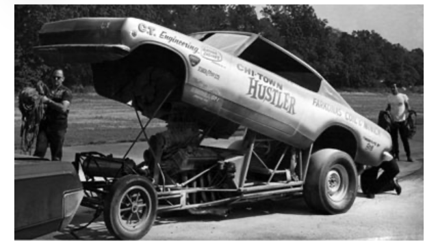

I can remember when funny cars were breaking into the 7’s. I think the Chi-Town Hustler was the first to do it consistently in 1967. Magazines called sevens The Twilight Zone.
31,172
65,679
Amazing when you see what these cars are capable of...compared to 1967...
