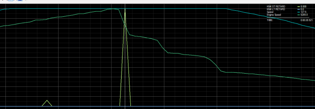

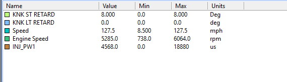

Well I did my first WOT pull today and got 8 deg of short term knock!
Injector duty cycle looked like it was 79 percent. Which is good. I was wondering how I was going to turn out running those.

I looked at the log again this morning. The chart is confusing because speed is messed up the blue line. I don't think speed picked up again until I dropped below 127mph. But looking at rpm (Green) it looks like the knock (yellow) happened right after I let off. There is a small amount of knock it looks like in 4th but it's only .5.

Any video of your knock? Able to tell it only by data log or could you hear it as well?

Only by datalog. Speed was higher than that I think for what ever reason the log stopped reading at 127mph and just straight lined.

Well glad I just took another look at the log this morning. The chart is confusing because speed messed up the blue line. I dont think speed picked up again until i dropped below 127mph. But looking at rpm (Green) it looks like the knock (yellow) happened right after I let off. There is a small amount of knock it looks like in 4th but it's only .5.

Try new gas and try again.
Sometimes modifications cause false knock. Rule out it isn’t real first.
