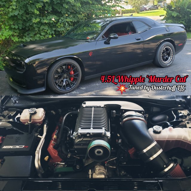

Currently in the process of finishing tuning on my Hellcat project. Been quite a process over the past year, motivated to see it complete now before winter hits again up north!
Huge thanks to 'Whip Cat' - 'SRT Stinkeye' and other whipple owners who've done a lot of R&D over the past few years.
Loving the car so far after about 1500 miles of seat time data logging. Night and day difference vs. Stock. First 60-130 hit was like a roller coaster :D
Car will have a flex 93/E85 map on the 5" pulley and one on E85 only with the 4.5". Dyno results will be posted once finished.
Big thanks to Josh and Curt @ Dusterhoff Tuning for helping guide the build in the right direction. Also huge thanks to 'Whip Cat' - 'SRT Stinkeye' and other whipple owners who've done a lot of R&D over the past few years.
Car will have a flex 93/E85 map on the 5" pulley @ 16psi and one on E85 only with the 4.5" @21psi. Dyno results will be posted once finished.

do yourself a big favor. Do not run the 4.5” pulley until you get the 426 built motor. save your engine man. if you do break that rule. Only run it at the track, don’t street it on that boost with stock rods and pistons.
any questions hit me up.
3,624
11,682
Listen to WhipCat ! Don’t boost that thing on the stock rods. You will have a very enjoyable ride at the lower level and when you’re ready to go rocket ship build the motor to take it. At that time... the Gearhead plenum spacer is a must. The only other thing is tires and suspension at the rear when you boost it. What you got ain’t enough. You spend a lot of money to make huge power.., you gotta spend some to use it. Whipple power isn’t like other power. You need tires. Don’t be afraid to go the 15” route. A 275 Radial Pro with a 2.62 gear or a 315 with the 3.09 on 15x10” beadlocks.

What made you go with the 1650 injectors?

I was one of the 1st guys to install a 4.5 Whipple. On the old forum I had a build thread till I got banned from there. I have played with it for the last 3 years. To be honest I'm going back to a stock ported 2.4 S/C. Should be done this week. The only way the 4.5 Whipple is really worth installing is if you go to a bigger cid.

Thanks for the welcome and advice!
Was told by Dusterhoff tuning the 4.5" was safe for this setup @ 21psi. 4.25" was when recommended to build the motor.
Definitely won't be running higher boost often on the stock rods. If ever ran will be going for a personal best in the 1/4 or 1/2 mile.
Very happy where the car is at now. The 5" @ 16psi is perfect for the street. Almost a dead hook from 40 on 17" beadlocks w/ET Street R. Can definitely see needing a 15" conversion with the 4.5" or smaller. Problem is that setup would scare a LOT of local racers off when they see the huge tire. :p Going to see what is possible on 17s/stock block before getting crazy. Believe the 'Omega' car did 8's on them.
As for fuel sticking with pump gas (93/E85) When built will shoot for 1100-1200whp. Not going for any records, trying to keep everything together like the rest of my builds over the years. (Not one blown motor/turbo etc. I drive the cars HARD) testament to quality tuning/not buying china parts. In the end the goal was a 1000whp street car, anything more is a bonus.
Currently stuck on the flex map - Seems to break up a bit rolling into WOT 30-50mph. Still a few gremlins drive-ability wise.
