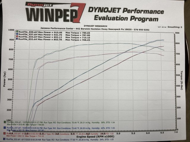

I switched to a flex tune in October, LOVE the added power. Added a solid 5 mph to my 1/4 trap speeds, here’s dyno graph of 93 and e85. Negative is car guzzles the stuff but I’m never easy on it, I think my avg is like 7 mph. M6 even in this cold of Pa I’m doing mid 11’s on cold asphalt. Fuel system if I’d but again I’d really look at Steve White Motors dual 285 drop in set up tat still utilizes a fuel bucket around the pumps as 1/4 tank really needs to be treated like empty as far as aggressive driving goes as the fuel pickups do get uncovered leading to a loss of fuel pressure. Yes, I use it from the pump, all Sumer while I was testing if every few weeks deciding if I was going to try it or not, it tested 83-85% all summer, tested 2 weeks ago was 75%. I purchased a 55 gallon drum of e98 that I mix 50/50 with the 75 to get 85 but I think the 75 would fair just fine on it own.

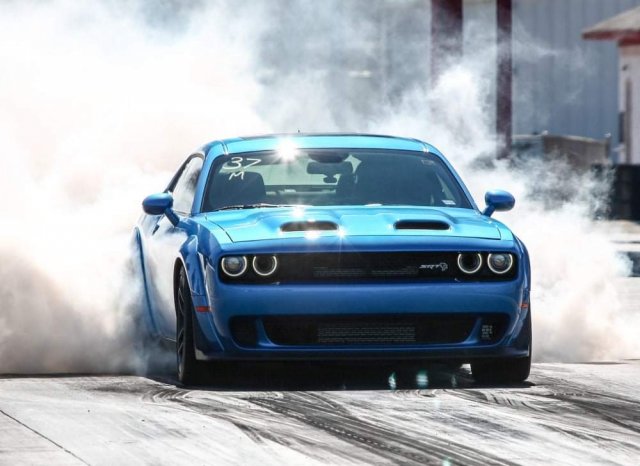

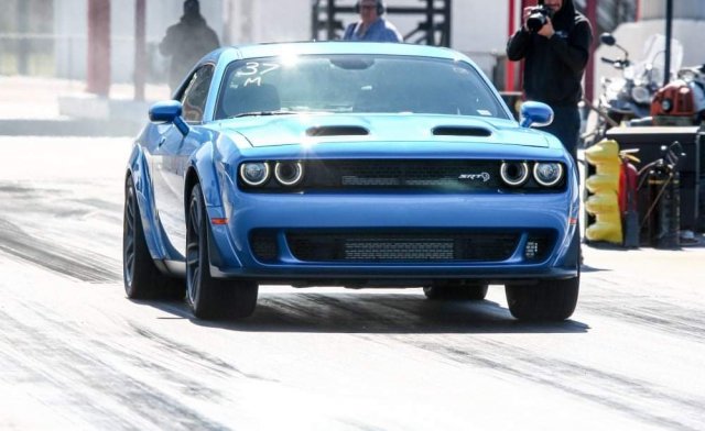

Curt, I may be contacting you about a few things. I'm curious what you think about what 93 pump is capable of with the 2.85 Litens, ID 1050's, 185* thermostat and custom tune. We weren't able to get an accurate number on the rollers but I'm thinking close to 800rw. I've been running this combination for over a year with zero issues. (18-19lbs of boost)
Love my set up, the ease of finding 93 on any trip and the damn good mileage considering the power increase, but wouldn't mind a bit more rw for these Texas boys running around with 850-900+ on a regular basis. Got a few max effort Z06/ZR1's and a few exotics I'm rolling with. Push of a button on good fuel to net another 75+ rw might be nice for some of our roll-ons. Not sure about going the e85 route (the extra $$$ for fuel upgrades and corrosive properties of the fuel) or just straight unleaded race fuel for play days. Just not sure what I can squeeze out safely with this combination (stock fuel pumps, 2.85 / 1050cc injectors) with good race fuel and a dual/flex fuel tune.
On pump, right off the street, full weight, Nittos and +1000 DA day...1.50 60ft / 10.06 @ 137.5.
E/T Streets could get me there but I'm trying to do this with the Nittos (roll in it at 1500rpms). Balancing act for sure but I like a challenge. A good -DA track day...gonna try again. FB_IMG_1612278150908.jpg FB_IMG_1612278156970.jpg

10.0 at 137 is a good run with the weight you're at on those wheels/tires, etc. One thing I'll say is E85 isn't corrosive. Modern fuel systems are designed for it, so no big deal there. I personally wasn't a fan until I started playing with it. I run a flex fuel setup now and it's freaking awesome. I had to tell Curt he was right as he tried to convince me a while ago LOL. I'm tuning it myself, and there are some intricacies so just make sure the tuner knows their stuff. Curt definitely does.
The big benefit with E85 is the volume of fuel. It has a cooling effect that keeps things nice and happy. You'll likely need bigger injectors though. The race fuel I use is Renegade RM109 and it's about $15 a gallon. Works great but race fuel is pricey. I literally run the same timing map on my alcohol timing table in the flex fuel tune as I have in the RM109 tune and E85 around here is less than $2 a gallon.
