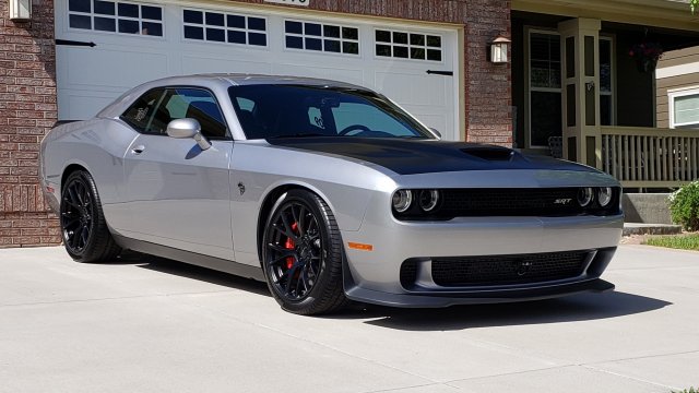

The blue Mopar springs are supposed to be a 20mm (3/4") drop for a HC, I barely saw 5/8", even after a year.
But, really, I'm very happy with it.

@BULL and @Hunter sorry for the necro-thread revive, just passing the time while I wait for my (standard) HC Challenger that I ordered, but the picture that BULL posted is the EXACT look I'm going for and wanted to know if either of y'all had the part numbers for those MOPAR lowering springs...?
When the time comes that the stock tires are (literally!) smoked, I'd like to go with a wider tire (285/40/20 I think...) and maybe spacer(s) to fill out the wheel wells a little better, eventually going with a staggered setup with 10.5 rears (and 305s), I just REALLY like the Brass Monkey wheels I ordered and hopefully can get some rear repros to get the extra width.
Thanks!
14,772
45,413
Thanks!
There's only one set of blue Mopar sorings that I'm aware of, I'll try to find them in my files somewhere.
About $300 if I recall
I did the install myself

These are the Mopar springs I used
https://www.speedlogixstore.com/product-p/p5155436.htm
Two things, I DON'T recommend this vendor, this is just a reference.
Note the years of fitment.
I also only got 5/8"-3/4" drop, not the 1.25" they claim, and yes, I've checked after "settling" time (about 1 year).
I really don't want anymore anyway.
Lastly, there have been reports of failed half-shafts after lowering, including from me.
Proceed at your own risk
