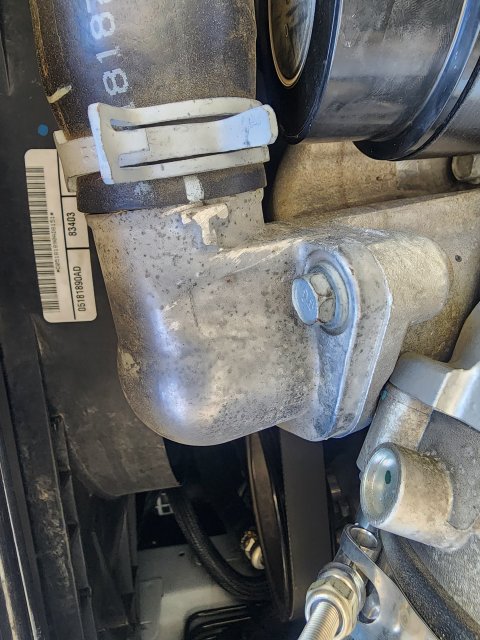

Was able to listen more closely and noise coming through here. Water pump is my guess. Have appointment next Wednesday to confirm. Have extended warranty and was told it is covered.
