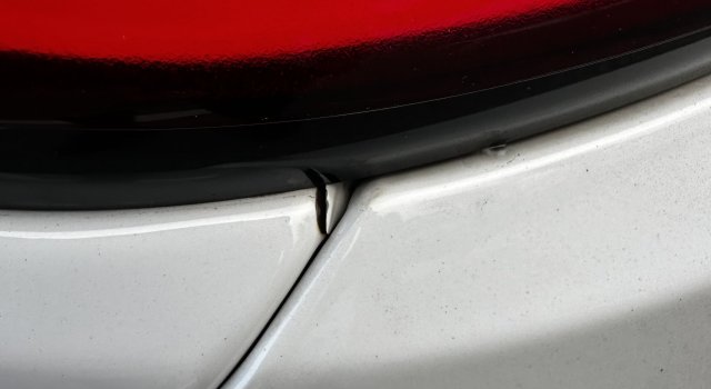

Not happy Dodge… 2022. Will be pulling tail light to attempt to fix later. No way this would be covered under corrosion? Bumper to bumper is out

Any tips on fixing?

I think it was poor panel fitment and the taillight cracked the part of the body filler at the corner, that’s what it is. That’s the quarter panel. These are notorious for that

Thinking about just pulling tail light, getting any bit of surface rust out, and then reattaching the corner with touch up paint

Growing up in my dad's body shop and painting my fair share of cars, leaving it be is the worst advice, but sometimes repairs can make the issue worse if you don't take the proper steps in the repair! Having a pro do it can be the best advice depending on the "Pro" but any competent person can make a basic repair such as this with minimal tools and skill. Prep is everything and you want to remove ALL the rust (mechanically or chemically) and treat with a rust preventative before your preferred method of reattachment. Just use good quality materials from an automotive store or preferably am automotive paint supply store (NOT from Walmart or HF, etc.) and take your time and I am sure you will do a fine job.
