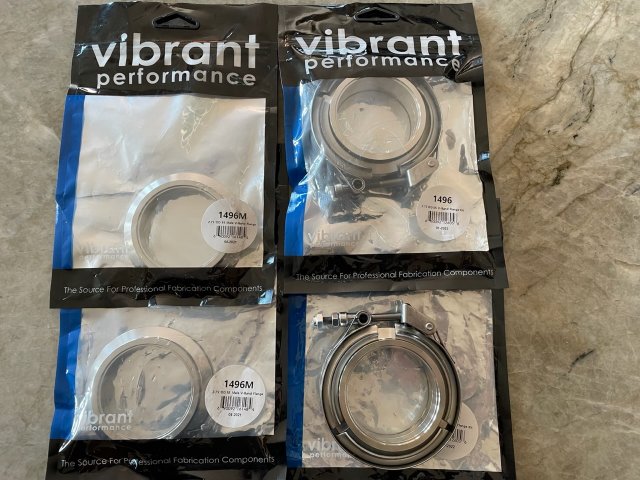

Wait a couple of weeks so 1) I verify it can be done successfully and 2) see if the V-clamps make it as easy as it looks to connect/disconnect the bypass pipes and the stockers. One thing I know already because it cost me $130 is be careful removing and screwing the damn sensors in and out. OR just get a couple of blanks to screw into the by-pass pipes and then just suck it up and connect/disconnect the sensors’ electric connectors. The week after RA I am having the boys weld the connectors up to the system and the two sets of pipes to return mine to stock for the streets again. If it all works well, I bet it can be changed out in less than 30 minutes easy.;)
Because I don’t know what you used for an adaptor on your by-passes, but the set I have has a skip-in one and that bastard won’t come out unless I destroy shit damn it!

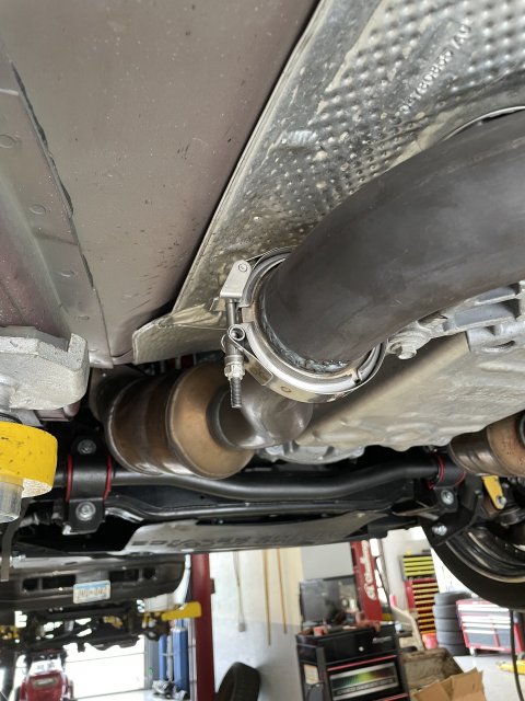

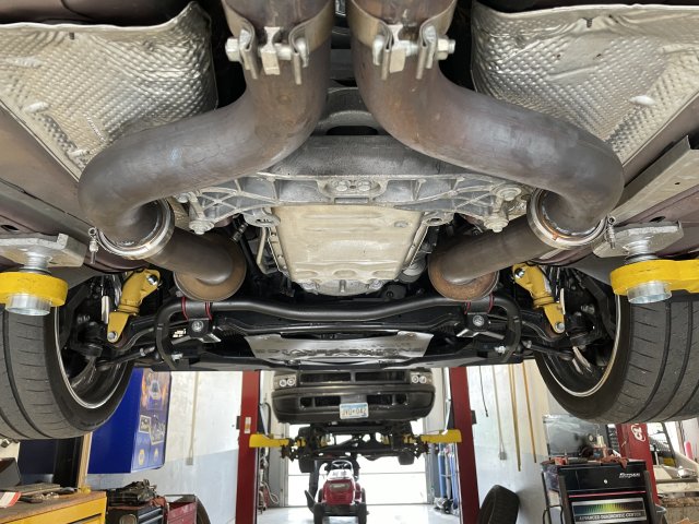

@Paladin06 I got it back today. So the clamps won’t fit at the spot where the exhaust system and the cat or by-pass pipes. After some thinking they put the clamps each side of the tranny. This makes both sets much shorter and a bit more workable. It sure sounds much different now VS without the big cans.
He just worked it from the big clamps that were on the by-pass pipes, plus they are 3”. I’ll need to minimize the clamps if everything works.

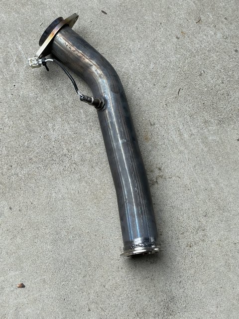

Shot one more picture before I pack everything up. The by-pass pipes are reduced to this. Much more easy to take in and out now, from nearly impossible.
