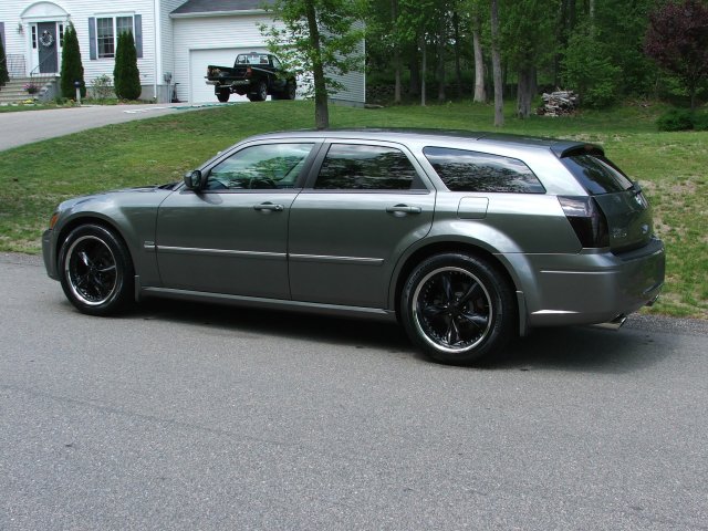

Mileage? I had an '05 YEARS ago and bought it when it was a year old/used (picture if from '06). Absolutely LOVED it and did some modest modding on it; SRT suspension, staggered wheels/tires, blackout grill/headlights, Zoomers exhaust (which was THE exhaust for the LX platform back in the day...). Volant CAI and a Superchips tuner...which ended up bricking my TCM. To their credit, Superchips actually paid for the tow to the dealership and the bill provided I send them the old TCM, which I gladly did.
Fantastic car. I would kill for an SRT if I could find one that wasn't either clapped out or priced like it's a CTS-V wagon (another ride I'd love to own).
They're solid cars; basically E-Class Mercedes and I believe an AMG NAG transmission IIRC. Issues with the motor, if any, were frequently related to the cam/lifters and I think had something to do with the MDS system. I remember being on the LXF (LX Forums) years ago and within a month of Diablosport releasing their tuner several idiots grenading their motors by turning off the knock sensors and advancing the crap outta the timing...it was amusing to say the least.

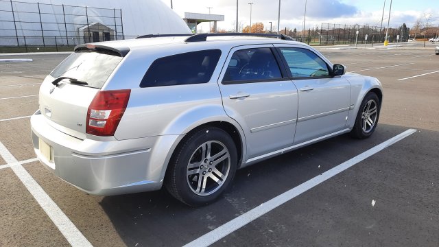

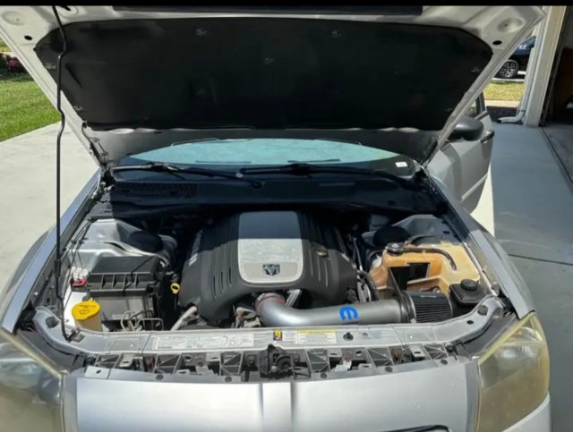

Asking $7500. I'm not going to be able to go see it tomorrow.
I am concerned because ownership has changed in the past year and I figure there's a problem that people don't want to fix.
Shifter was fixed. It is on the Carfax.

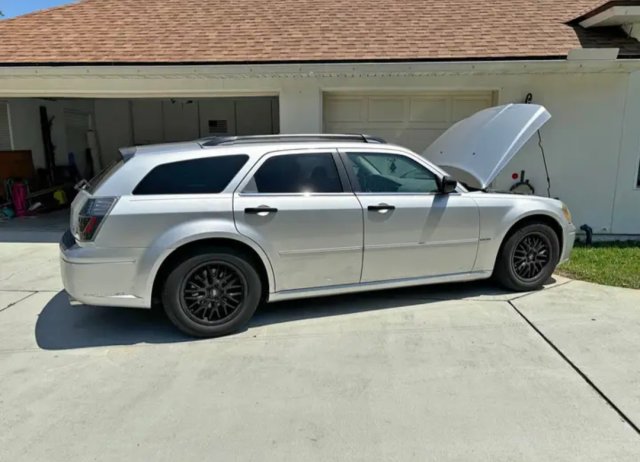

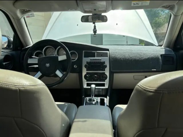

Screenshot_20240518_152555_Facebook.jpg Screenshot_20240518_152608_Facebook.jpg
That's reasonable...and suspicious at the same time. Always love asking people why they're selling and watching the ensuing tap dance. Give themselves enough rope to hang themselves with and then tell them to fuck right off, if applicable.
It's 17 years old at this point which, depending under what conditions it was owned/stored, could be of little consequence or an absolute deal breaker.

Doesn't look too shabby but hard to tell of course. Headlights are understandably smoked which isn't a huge deal. Are you looking to wrench on it or just want to buy and drive without modding?

According to him, he's a college student and can't afford the gas... Screenshot_20240518_152808_Facebook.jpg
