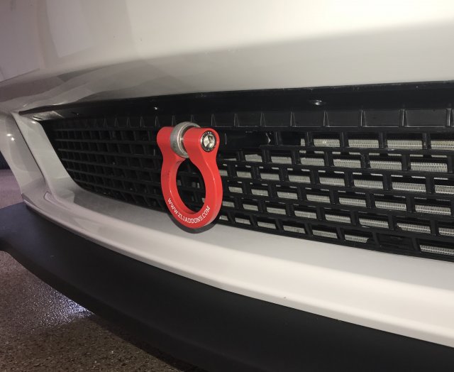

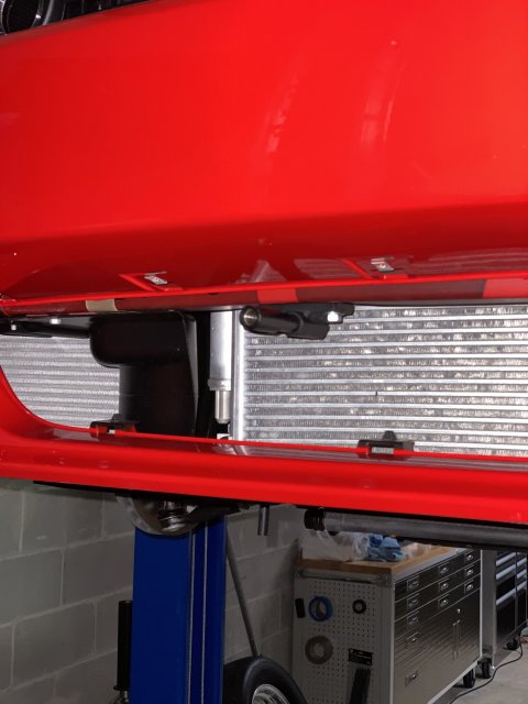

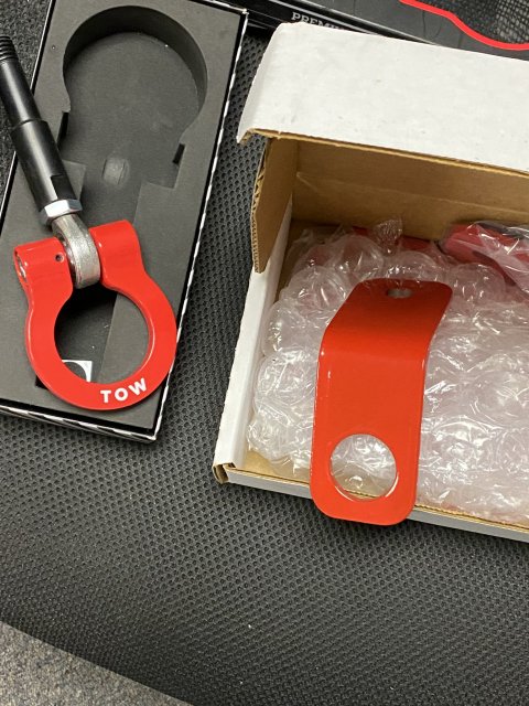

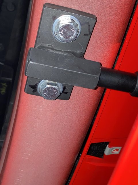

Some work for sure to install this tow hook!
WidebodyCat
WidebodyCat
#3261
222
307
Holbrook
2019 Widebody Hellcat
All done. Ready for track!

Did you have to take the entire front valance off? Or just the underbody tray?

I watched their video on how to install the front tow hook. They didn't take anything off the front - none of the fascia - they took off the pans and drilled up from the bottom. It looked a little tricky as far as getting the hook's shaft to come through the fascia grill without cutting. I asked Zl-1 about this a couple of months ago and was not fully reassured coming up from the bottom would work on a Red Eye - that maybe there was an oil cooler radiator in the way?

I have the 2020 Super Stock. So on mine..Only bottom grill had to come off front..
Complete underbelly and full spoiler removal was necessary though. Like 25 plastic rivets had to be drilled out and replaced. Not to mention countless screws and pushpins...Dodge should have this built in like my other cars!

If it's the video I watched, it was done on a Charger...and not a Hellcat Charger. So no intercooler, and plenty of room (compared to the Challengers).
The issue is there isn't enough room to drill 2 straight holes up thru the crash bar without risking damage to the intercooler and such.
After seeing WidebodyCat's pics, I thought there might be a glimmer of hope. But reading what he had to go thru, Seems it might be as bad as just taking the nose off and being done with it.
As to the rear hook location, there is a different mount needed for it. You drill a hole thru your rear lower bumper (behind the license plate) and then drill into the rear crash bar from there.
After my struggles with the front, I haven't even attempted to look at the rear yet.
