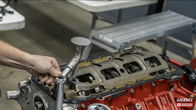

Most Oil pan gaskets these days on performance engines incorporate windage trays, the Hellcat and Demon engines have such already
Mike is that you from the other site? Is that all you got? Cause then NO ONE has an in depth answer and I'm really screwed for info. LOL. The squirters put it in the mix above the pan (and the Demon doubles down) so although the tray helps a bunch, it's inescapable the oil getting caught up in the rotating assembly. Just was thinking about this for awhile ,don't know why. Prob part of my OCD. That's really a good picture. You must've googled a few to find it and took some time, thank you very much for the response. Tony.

Yes it’s me :)
No, only took a few seconds to find
Grab a beer and Watch this on a big TV
With cranks being deep in the block anymore make it harder to scrape them clear of oil anymore but engineers still do a good job at it.

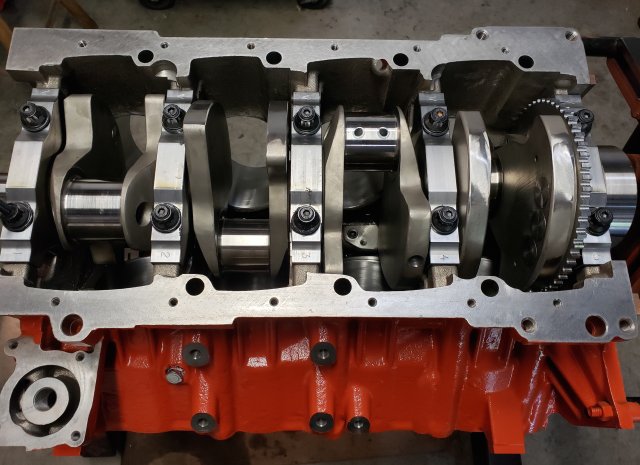

The Gen 3 Hemi comes with a windage tray that prevents the oil sling that is a issue. Light weight oils with anti foaming formulas all address the issues that they had back in the good old days. But every little “hot rod” trick helps. My billet crank has been polished in the area that engages the oil. The smoother it is the less it will carry. Attention to detail is horsepower. :cool: FFD7335E-6D7E-4248-8CD6-97825D5FD972.jpeg
