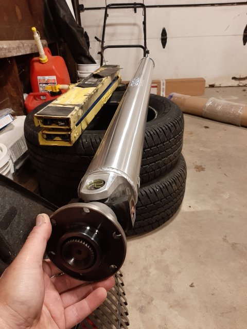

Wiles 4” One Piece DS

Why is 2 piece better than 1? I’d think that less can go wrong with fewer parts. Thx for the education from anybody!!

Due to the length from trans to diff...the build mandates a 2pc to maintain the critical speed to actually reach the car's top speed.
A 1pc at this length actually lowers the critical speed enough to cut the top end down almost 30mph in the case of a charger.
