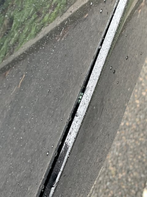

Noticed today one of the rear arch clips has popped off (nothing has hit it).
It was raining so I didn't fiddle with it and wondering what the best technique might be and better to ask before giving it a thump.
Thanks

Thump is appropriate. The rear flares install with clips only.

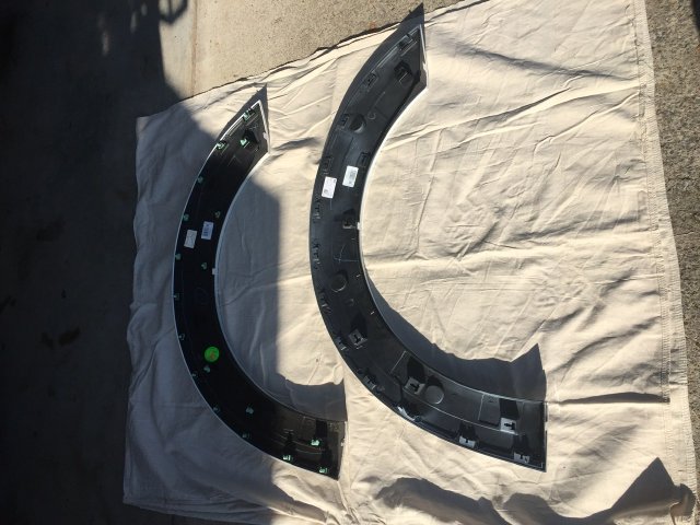

Had a look but can't find part number or what sort they are, is there somewhere better to look than this please:

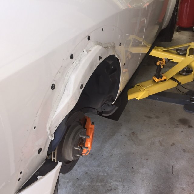

I reused my original clips, the online parts catalog isn’t very clear what clips are used.

Best pics I have of the rear flares.

That's really helpful thanks very much (y)
